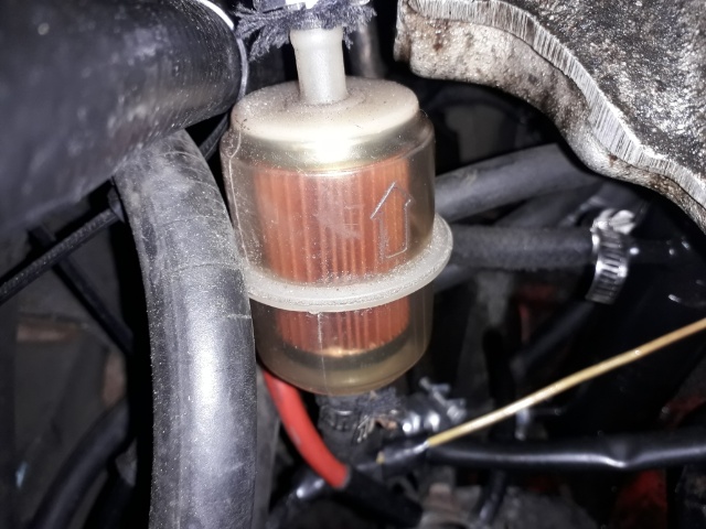

Right, bits of news. There was a big drop in the fuel level over the last couple of days...

Not quite fit-and-forget since the car had an occassional issue of idling too fast (2000 rpm) which I couldn't easily sort out. I had noticed that the problem was due to the plunger at the side of the carb (which is to do with float chamber ventilation) kept getting pulled into the down position by the plastic lever. However, a couple of hours fiddling about revealed that it had a *very* simple cause - the choke cable had become a bit bent in all the previous shenanigans and was not allowing the carbie cams and levers to go fully back to ground-zero when the choke was pushed in. However, after a bit of straightening, I can sleep peacefully now.
And, the starting is OK, too.

The car started after 2-3 weeks standing with fuel level in the filter really low and on a fairly flat battery. Non-return valve seems to do the business.

Thank you. I drove the 360 yesterday without any problems. The non-return valve seems to solve the problem as the car always starts now. The mixture is a bit rich, though. Maybe, a tweak of that well-hidden screw is needed. Cheers, bogs.

Yo! The car was left standing for a week of fairly solid heat and it started after a few tries, so I think its more-or-less fully sorted by the non-return valve.
