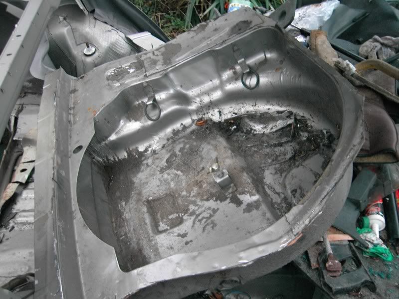

Dai, as we all know I didn't make it to the meet. I hadn't had time to cut the boot floor out either. Anyway, I found a spare couple of hours tonight, had stocked up on cutting discs and got myself a grinder, as I didn't want to kill my Dad's one! I thought it might be a bit difficult due to the chassis rails running front to back. And theres a folded lip that's spot welded to that. I managed to get a good extra amount around the well to the n/s of the car, as the wel is off centre, and at the back I cut some of the rear panel out fo you. One thing I have since considered, is that the donor is a saloon, which overall is longer, so where it makes up the extra length at the rear I don't know, it's nothing more than 100 mm or so. But I'm sure you'll make it fit somehow!
However the o/s is very close to the box section chassis rails. I managed to get 50 mm worth of boot floor that side, but towards the front of the car I could only manage 20 mm or so from the wheel well return to the cross rail underneath. I'll take a picture in the daylight tomorrow, as if it's no good to you, I've another 360 I can try and do differently.
I had trouble seeing, as the goggles I had to hand weren't ones that fitted over my glasses, so the glasses had to come off! Made things interesting, in the dark with a headlamp on! But at least things can progress with the shell, the parents aren't too happy about how long it's taken.

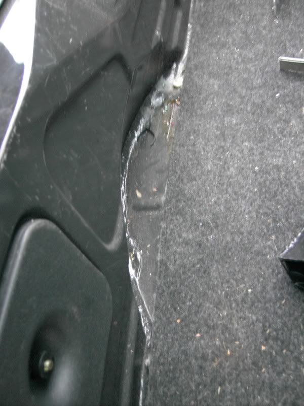

Right, Dai, there is actually a difference in the wheel wells between saloon and hatch. I had a quick look in the boot of the vario 340 GL this morning, and despite not having a wheel well, the rear panel under the boot catch has a dip of the wheel to sit into on removal. THe saloon has a completely flat panel under the catch. THe extra boot length means they did away with the dip. The saloon one is right up to the central chassis crossrail, and then nearly mets the rear panel. Either way, I'm sure you'll be able to mate it up to what's already there. Pics later.........

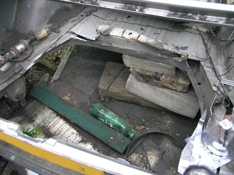

Hmmm, anyone fancy the extra ventilation model of the 360 with the hole in the boot floor, not much use for carrying loads tho!? Notice how clean inside the box sections are at the rear? Pretty impressive.

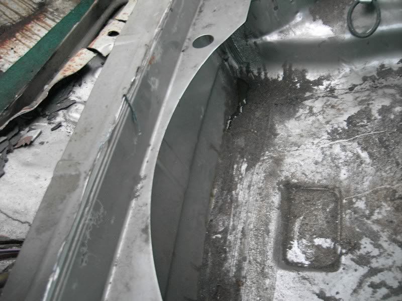

Dai, your removed wheel well, I had to get quite close to remove the well on the right and rear sides.
Dai, not the difference between this saloon version and the 340 hatch below without wheel well, but the dip is incorporated into the rear panel. I'm sure a man of your calibre will be able to sort it out.
