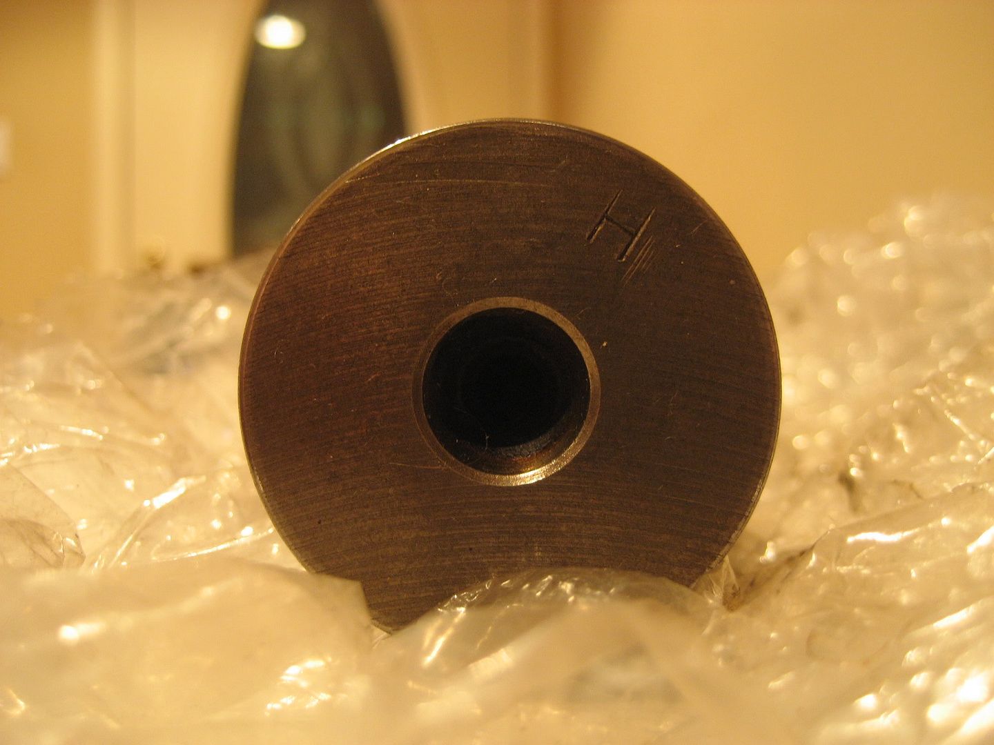

A toy arrived today :D, if I can sort out my uni work then I'll try and get cracking the 2.3l head rebuild over the weekend and post some pics.
http://i7.photobucket.com/albums/y300/V ... G_2588.jpg
Whats the deal with the H cam btw? What were they originally fitted to?

Post by Fuse »
SteveP wrote:Whats the deal with the H cam btw? What were they originally fitted to?
1979-1980 B23E 140hp version. 405 head, forged pistons and the H-cam.
