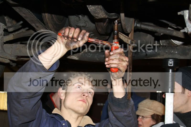

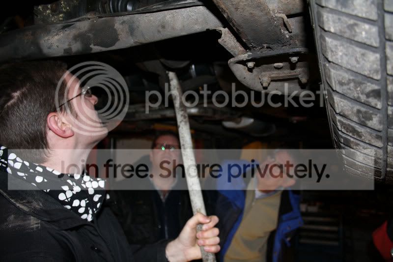

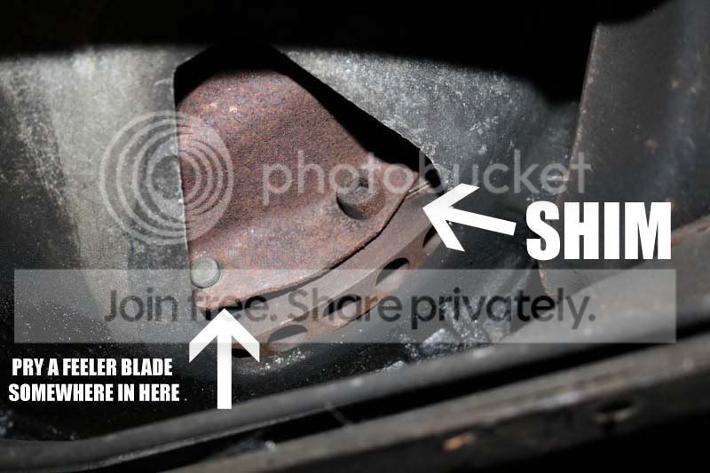

Daf 46, Daf 66, Volvo 66, Volvo 34x... tis all the same beltwise. I don't know what you're after (new or used belts) but if you're opting for some good second hand ones, please make sure that their turning direction has been marked, or otherwise they're just plain useless. I'd still go for new stock though. Those new kevlar-strengthened belts live for ages when looked after properly.
Since you've had some problems locating where you should measure your clutch plate clearance, here's a handy pic. Please note you should check it at three different points (between every two shims that is) like Mr Haynes says. You can either crank the engine or turn the wheels, what works best for you. All these pics were taken on a very useful 'short introduction to the variomatic and its foibles'-day I've been to recently. The other photos show the actual process of changing a belt: there's the nice way of doing it with a huge clamp, or a way that's a bit more violent. On the plus side, using any old bit of scaffolding (preferably a piece that's 3 to 4 ft long) to get your secondary transmission's cooperation takes half as much time
