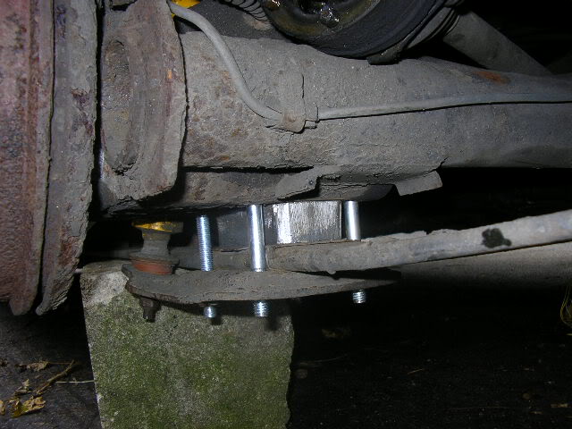

ok, so after posting on here again i kinda got reminded, hey got some cars to finish. so i decided the suspension upgrade on the volvo might be a quick task.
this has to go in:
Re: German 360 (16v project)
Posted: 21 Feb 2010 08:18 pm
by Cutler
I've put it all in, looks good, works fine.
Except the rear dampers. Seems to me they are to short. If you press the rear down and then release you can hear a "bang" from the dampers because the suspension can't fully expand. Got the dampers from Dai so they should fit the car I guess...maybe some mistake by me?

by Dub_Addict
i think your problem may be that the lowering blocks are incorrectly fitted. they are supposed to be above the lowering spring.
hope this helps!

by Cutler
HOLY SHIT
Thats one stupid mistake by me! Of course it can't work the way I fucked it up! I had a look at Dai's guide before I went on to fit the blocks but somehow missed to check for the correct position.
Thanks for the clarification!

by foggyjames
Unless I'm missing something, that won't change the shock mounting position relative to the body by more than about 10mm, though.....how much is it out by?

by bodejodel
It will bring the body closer to the shock mounting plate by [block thickness] mm... Or am I missing something? :wink:

by Cutler
Jep, about 2,6cm.
I should also be able to gain 2 cm or so by fitting spacers at both ends of the damper. So if the correct mounting of the blocks is not enough, that should do the trick.
