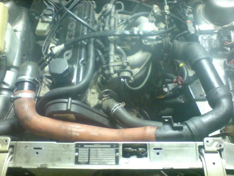

Sunday afternoon scrapyard bodge;

what is that red boost pipe off? looks perfect lol

IIRC that red pipe has Volvo printed on it and was found on the deck lol. It was all a mishmash from whatever was in the yard. Bits of Megane Scenic there too. :lol:
