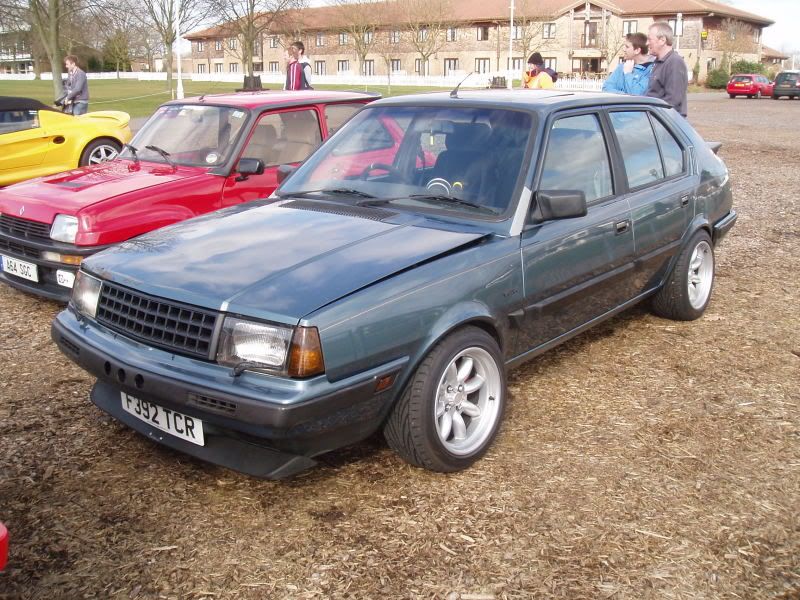

Had a good run on weekend and no problems! Can't belive interest it had at Race Retro..Made some "adaptors" to able use of std 360 handbrake cables with rear calipers.
Dropped them off to be machined today, will be on friday! Cleaned up front spoiler, getting rid of pop rivets and trimmed it for better fit. Also measured up for rear multilink.. :D installed lambda sensor in to exhaust, just waiting for A.F.R gauge..
