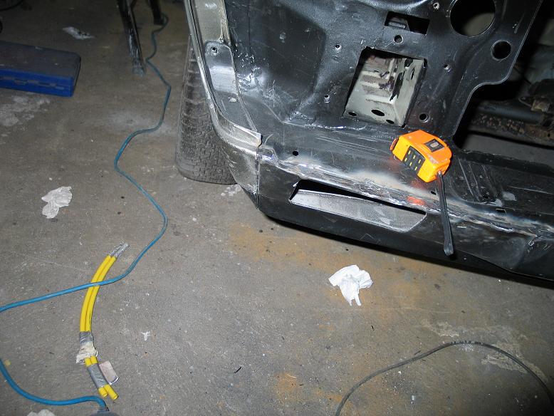

Unfortunately the wings don't fit too well at the front. Its possible I havn't fitted the valence back on well, too tight perhaps. The valence panels came from different cars so I didn't have the original spot weld holes to line up on. Suggestions, modify wing or reweld valence top bit? It may have to come off all the way along, next step is to try the other wing.
Foam in the air box wasn't too good.  Replacement?
Wing doesn't fit well on the front valence
102mm ?? what does anyone else get?

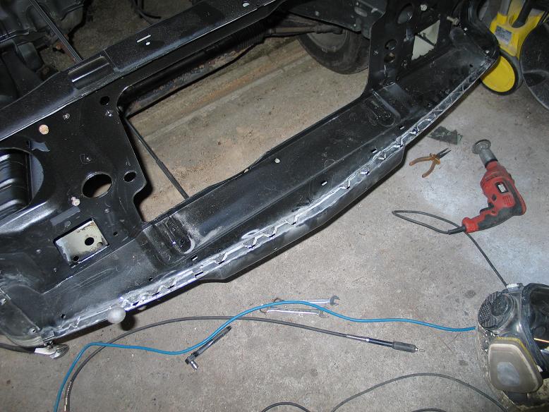

Posted: 30 Apr 2014 01:21 am
by Ride_on
Fixed one problem, lovely job, found another ..commit suicide!
Cut the rewelding out
welded up the gap, about 4mm, fits perfect now.

I've been up to the same stage in the past couple of weeks.I think its coz when we remove the front panel we take the time to remove the 4mm of stone chipping that is also between the spot welds.I've gone with good door and bonnet gaps and will worry about the valence gaps later.

I don't think it was missing stone chip, just bad assembly in my case. Sorted now.
