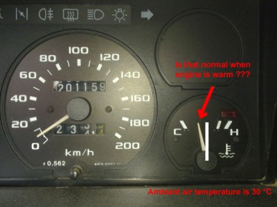

dfeghali
Posts: 38
Joined: 26 Jan 2010 09:24 am
Location: Beirut, LEBANON
Re: Never gets over half way on thermostat
Post by dfeghali »
I have the same question about the teperature gauge...
1983 Volvo 360 GLT (Black)
Posts: 2265
Post by Ride_on »
no, you need a new thermostat or the correct one. Thats usually the offset I have seen in the past when the wrong thermostat is fitted. Check your owners manual for the correct thermostat opening temperature, and compare with the one that in, it should be marked with the temperature.
dfeghali
Posts: 38
Post by dfeghali »
Cheked the manual and it should be open at 92°C (B19E)...I'll check the fitted one...like you said, it should be the wrong number...
Is there any problem if the engine runs cooler :oops: ???
As far as I remember I changed the gauge temperature sensor with one that has this volvo part number : 460191...Is this the correct one ???
Thanks a lot for your help :D
David.
Post by volvodspec »
the Smith sets as above do have a habit of showing a lower gauge reading than it actually is.
if it stands somewhat the same when it's 25degr outside; it's fine with the Smith clockset; on a VDO it would read out nearly perfect in the middle..
