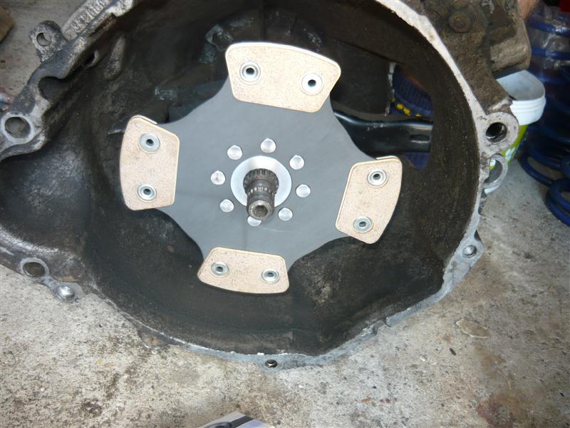

Re: renault 5 gt turbo clutch and backplate advice
splines are the same, i just tried it:

- volvodspec
- Posts: 1921
- Location: Netherlands.
the flywheel is 7bolt on both the 1.4 and 1.7, diameter is definatly different as it the pressure plate's shape
so i don't think you can mate a 1.4 pressure plate to a 1.7 flywheel
though the 7bolt flywheel is the same for 1.4 and 1.7, i also believe they have a different pcd
