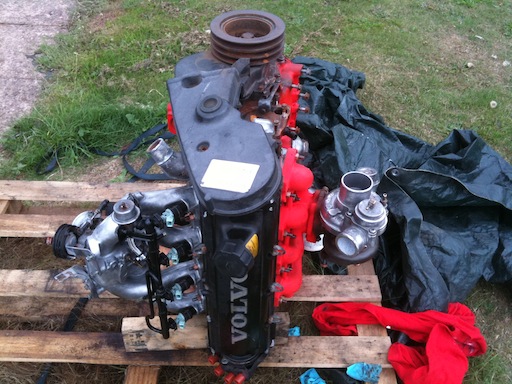

Hi Guys,
At some point I'll actually assemble a proper build thread for my beloved 360, but I'm getting to the point now where the only thing stopping me from doing the physical swap is the lack of a crane! That aside, I also have some questions. I've never done an engine swap before - this is very much an educational project for me as much as anything - and I've got a fuel injected '89 360 GLT with the 2-litre NA engine. I've also got a '94 940 2.3 Turbo engine that I've been painstakingly tearing down, cleaning, painting, renewing and reassembling, ready to do the swap.
I understand that I will need the mounts and sump from the old engine, as well as some of the ancillaries (starter primarily). I'm gonna have to figure out some of the vaccuum hoses and water piping as I go, because I never had a chance to see the 2.3 in it's original vehicle, and the Haynes manuals are pretty useless in this department. But the big question right now is the loom...
Now, I've been comparing the loom in the car right now to the loom I have with the new engine. It's a two-part thing, the first bit wrapping around the block with the connections for the knock sensor, idle air control valve, injectors etc. on it, and terminating in a set if huge block connectors for the second loom. Thing is, I can't find a similar set of connectors on the existing loom, and the secondary part (the bit with the ECU connectors on in 2.3 flavour) seems to be pretty tightly wound around the engine bay, snaking through the firewall and connecting up to the existing digital ignition and vacuum advance modules.
So, long tim getting here I know, but here's my question. I know these swaps have been done before so I'm hoping someone will know the answers!
1) Do I need to tear out the dash and ditch the entirety of the old wiring?
2) Are there any technical resources out there beyond assorted Haynes manuals to help me with vaccuum and water/oil hose routing?
3) Anyone with previous experience/advice on fitting a dedicated air-oil cooler to these turbo units? I understand that default item is a water-cooling system, seems like a bad idea...
4) Anyone know how the ECU on these things responds to simple boost control, such as a dawes device? I'm only talking a few extra PSI, nothing epic (yet!)
5) Anyone whose done this before - or indeed any engine swaps at all - any general advice/pitfalls to avoid?
I've spent a lot of time making this new engine shiny and awesome, and with all the other work I've done to the car I don't wanna ruin it now!
Thanks guys!
Nick
