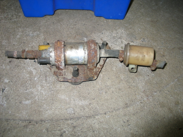

Its before the pump, a smallish low pressure plastic type job you would see in a powerful carb car. The pump sits on the big shield with part of it over the exhaust at the back of the car (has a big U shaped section in it). The filter goes between the tank and the pump. A generic fuel filter should do, anything suitable for 10mm pipe I think(pushon + jubilee fitting). Make sure the pipes and hose clips are in good condition, as you can see mine are pretty knackered, and the pipes are very hard (87 GLT saloon).

Yep, just found the plastic filter, mine's black though. The hoses either side are starting to show signs of deterioration/cracking and I reckon they should be replaced. I suppose I'm going to need to drain the fuel tank to do that, am I?

I wouldn't use a generic carb filter with paper filter element inside as it's not designed for such applications as the stock setup is.
That stock "filter" beside the pump isn't actually a filter but a very coarse all-plastic chamber type "filter", which also helps with the condensed water in the tank.
The generic carb filter will work, but it will cause way more resistance to the pump as it's not as nearly free flowing as the stock chamber-type part. I had a paper type filter in place when I bought the car and you could hear the pump cavitate occasionally because of that. I ordered the stock filter from Volvo and pump sounded more healthy immediately.
That stock filter isn't available from anywhere else than Volvo.

One of the few parts that Volvo still do for the 300-series, luckily. They're pretty cheap as well, so it's worth while buying two if you plan on keeping the car for a bit!Fuse wrote:That stock filter isn't available from anywhere else than Volvo.
Re: GLE injection fuel filters
Thanks Tom. Yep, I got one from my local Volvo dealer - but you're right, I should have got two!
I bottled out of changing it myself, and got my local garage to do it when I took it in for the new cambelt. They also did all the drive belts as they were looking a bit iffy too.
So it's running sweet as a nut now!
