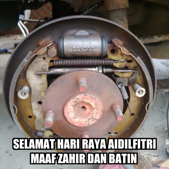

Hi mac, thanks for sharing the page..i suppose I won't need to shop one, I have got it from scrapyard, and already installed it. I think I have check again, the placement of brake shoes and spring..maybe I wrongly positioned them..i've replaced the wheel cylinder pump..lucas brand.
- Attachments
- Can you trace any fault?
- MockIt 1.jpg (134.41 KiB) Viewed 13955 times
