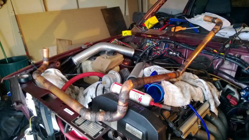

We've got the swaybar crossmember thingy re fabricated and back in. Also I got some pictures of the turbo oil drain set up and what we've started doing with the cooling system.
We should have it pretty much in drivable condition in 1-2 months so not much longer now. Then we'll be getting into the suspension and brakes.
Cheers.

Post by Ld50 » 15 Sep 2013 11:29 am
Here we are.
The car is almost done. We've made quite a lot of progress in the past month. Here's the pictures.
The exhaust was a bit fiddly with the 3 inch down pipe and all. There's still a bit of work to do on it though.
As you can see there is not a lot of room in the front there. Couldn't find a 6pk belt in that size so we had to use a 5pk.
At the moment the car runs really rich, and the fans kick in after about 5 seconds of running, so I'm assuming it's just the coolant temp sensor (here's hoping)
I'm pretty happy with the front end of it. Can't really even see the intercooler piping with everything on there, so if the bonnet fits fine I'll be happy.
If the sensor fixes the mixture problem, there will be a video of it driving tomorrow. I've got the fuel pressure set to manufacturers specs so altering that will be a last resort.
