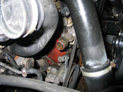

The spare 940 that has been sitting at the side of the house for a year or so did have anti-freeze. I meant to drain it but forgot of course. Just checked it now its -7C and the coolant has turned into a slush puppy.
Hopefully its not gone solid anywhere, have just replaced the airbox with a 1.5KW fan heater, hopefully it will drain. Some water already came out so maybe it will have space for expansion.
Any advice? do I need to drain the head specially?

Well I had the fan heater in the 940 engine bay all night, no more signs of ice at the water pump, so finger crossed it will survive the winter.
