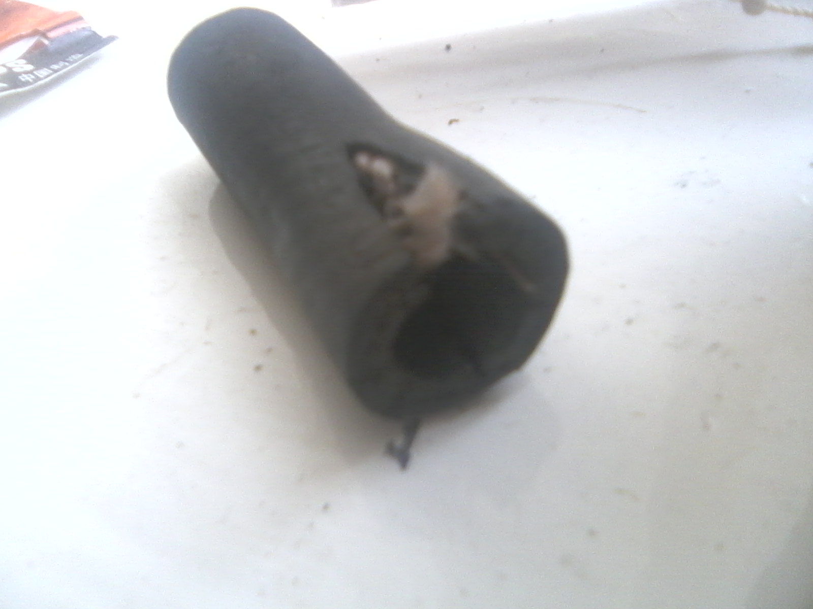

This bit of old, split, perished, manky, cannibalised coolant pipe was my brake servo pipe 'connector adaptor'. Interestingly- The servo pipe fits the manifold perfectly without it. - now looking for the shortened coolant hose.....
It ticks over properly now and starts a damn sight easier when warm, doesn't surge and wane all the time - Win!
