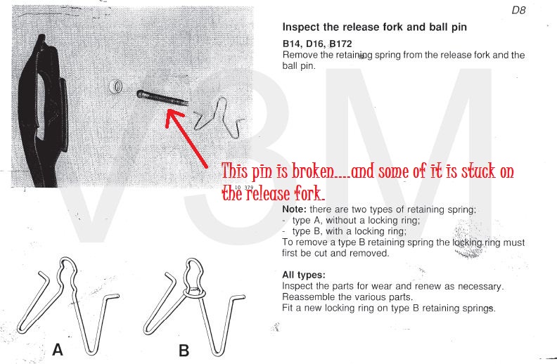

By the way, if you're not sure of what I meen, here's a picture.
And half of the pin is still stuck on the release fork....

WaxFraq wrote:My plan is to cut(!) :shock: an "inspection hatch" in the clutch housing. Just beneeth the ball pin entering. Probably not a good Idea, but what the "F" am I suppused to do? :roll:
Pull the propshaft out and take the bellhousing off?

Yeah, I've seen the Haynes...but it seems like such amount of work just for that bolt...
Re: 340 DL B14 Clutch problems
Less work than grinding! Prop off is easy on these

I think sadly you have to pull the bellhousing off. Depending on clearance, you might just be able to winkle the bellhousing past the exhaust, otherwise you'll have to take that off too. Its not all that much work, but yeah I know its a PITA for a tiny thing. I once had to rethread the long brake line that goes between the front and back brakes. Because it was pushed in up past the handbrake cables, and the car was a 360, we had to take the whole gearbox out. And of course, it was an MOT failure so we had to do it in a real hurry......real PITA. Pete Farrell helped me with that one.....in the p*ssing rain, how typical!
Anyway, I think that even if you do manage to grind a 'window' you'll have trouble releasing the clip and getting the bolt out and the new one clipped in properly TBH.

I just gotta say thank you for persuading me to rip it apart..! It was not to much work...and got my self a little laugh when all of the parts where laying around the car.
Next time... :lol: ...I know how to deal with that one..! And it was kind of instructive to!! Had to weld a new ball pin, and it worked just fine!
