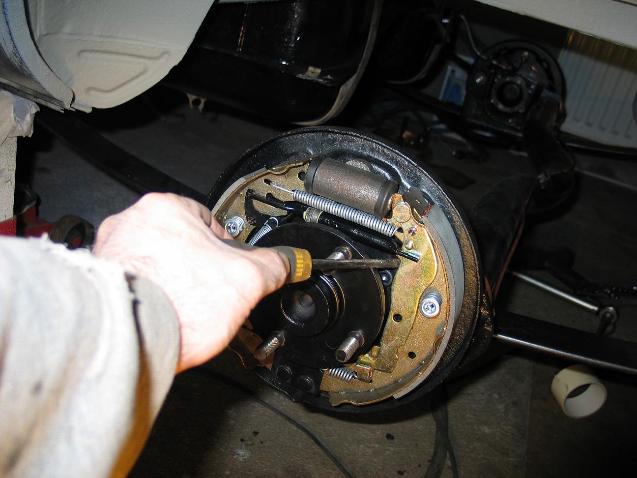

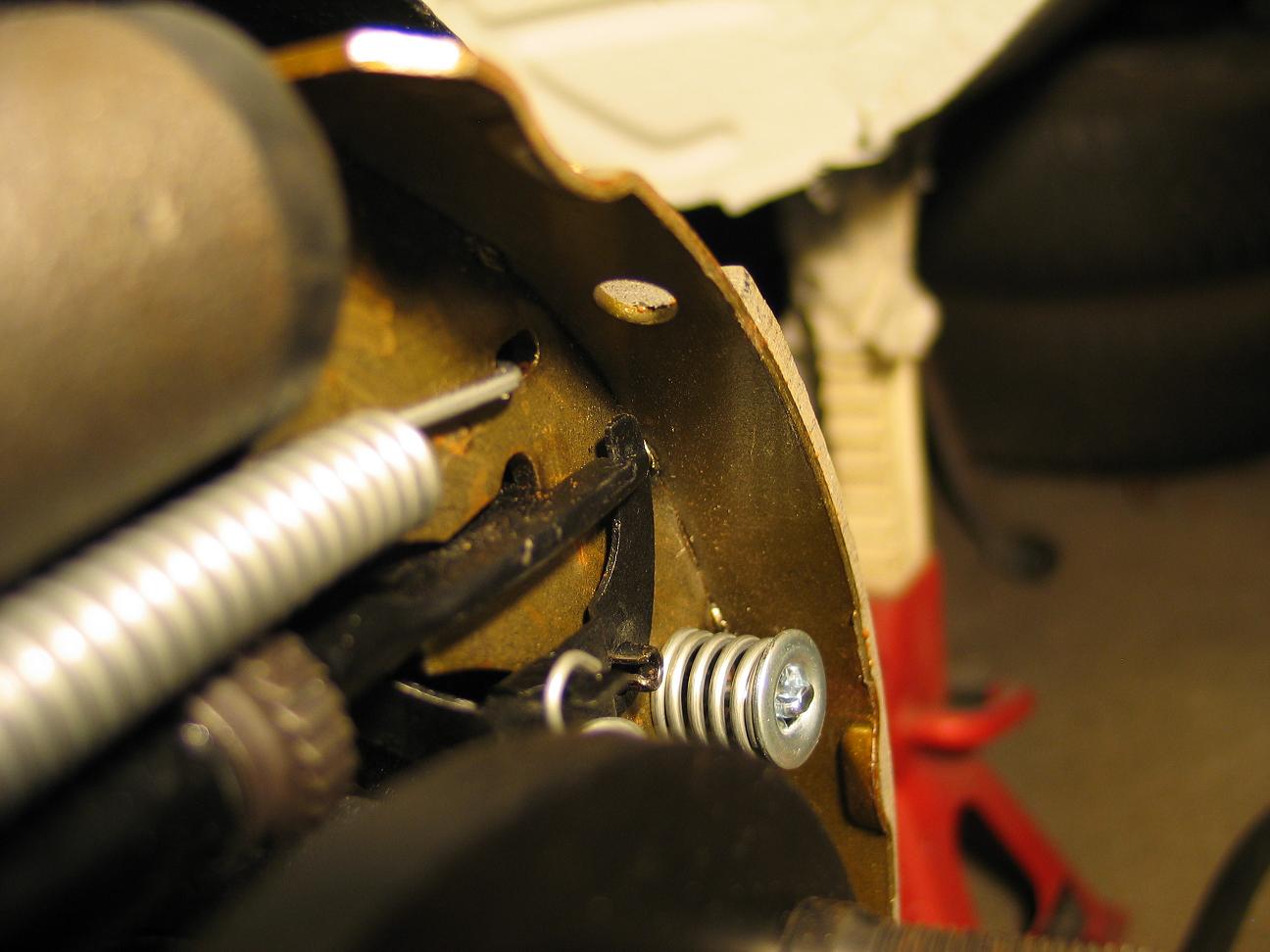

Thanks Mark will check out next time I'm up but have guessed based on replies for now.
Above assumption for adjuster seem correct. Screw driver test spins the adjusters nicely after fettleing. I did have a problem with the adjuster lever plate thing, that gets stuck in behind the adjuster forks, it won't engage the ratchet nut then. Forks maybe a bit worn or the lever bent a little, no new parts in fitting kit!
A good tip is to fit the adjuster lever last, after the adjuster forks are fully pushed home and springs holding everything together.
