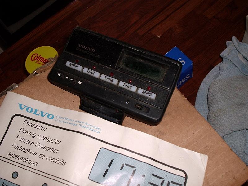

Trip counter - http://www.chesh.co.uk/300trip/comp1.jpg
