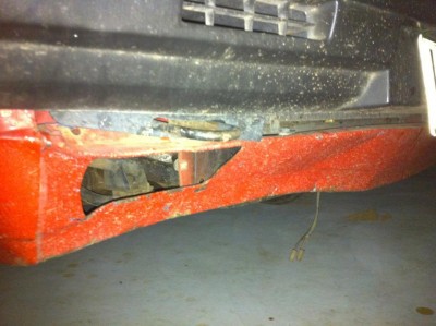

Haven't posted in a while, thought I'd share with you.
Anyway, I'm from Australia (live out in the country), and was driving home from work late the other night, and decided to go a different route home, for a bit of a drive, just for something different. So here I was, not really concentrating (cos I'm still a P plater and I haven't really learned how haha) and all of a sudden this kangaroo jumps out in front of me. I slammed on the breaks, but didn't swerve or anything and felt it hit. I pulled over the side of the road, but didn't see any damage til I got home.
Basically there is a dent in the underneath thingy of the car, and I lost the right fog light. No big loss, it never worked properly anyway. And I hardly ever need them. But I went out the next morning to see if I could find the light, and this is what I see.
I sure as hell hope my little 360 didn't do all THAT damage. But then again, it should do a lot to keep me safe, being Volvo and all :P
Should I just be able to get this popped back out, rebent, or whatever? Or will I have buy a whole-new metal front part? And the fog-light, is there any sort of specific kind for this model of car or not? Thanks.
Anyway, I sure have learnt from this experience. Concenrate, and don't go back ways haha. Hopefully I haven't grossed anyone out either.

You didn't take a roo out (or it was a , the front of even a Volvo would be a lot worse for wear if you did.
If you took anything out, then it must have been something like a mini-wallaby type of thing. Maybe. I dunno.

You might be able to bend some of that out, drill holes in it, screw some self taping screws (Nuts and bolts would be better if you can get access through the back) in the holes, put some wire round them and pull out with some sort of straining device fixed to something solid. I did it using a monkey strainer (fencing tool for straining barbed wire etc.) anchored to another 340 tow hitch! Then you will need to remove all the paint & under seal from the area to fill flat and re-paint & under seal. At least it's an area where imperfections don't show up easily.
The fog lights are specific to 300's, may be hard to find over there.

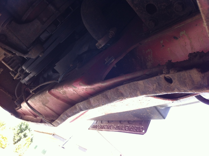

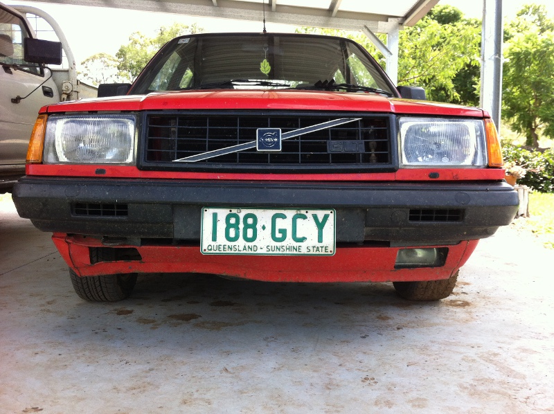

5 minutes later... okay, well it's not entirely straight behind the dent-of-damage. A little bit bent. Here's some more (daytime) pictures of it, that I just took.
This is where it is slightly bent, underneath the front. Is this bad?

Nah looks fine, might be worth just yanking it back out again.

Came across this one a bit late. Nasty damage, but boy you were lucky. I've seen mega damage done by roos, to much bigger cars and trucks with roo bars and everything. You guys in Aus are much more likely to hit roos than us Brits are to hit deer, badgers foxes etc. You do see some carnage and roadkill in certain parts of the country, but there are parts of Aus where you'll see roo bodies lying every few km or so and they're a real pest at night. There are parts of the outback where the only vehicles on the roads at night are large trucks because there's so much 'wildlife' roaming the roads at night that its just a matter of time before you hit something.
Anyway doesn't look as though its structural, well, not into the main chassis box sections anyway, so that's good. Erm, I would see if you can find somebody with a puller and try and pull that dent out. If not, then try knocking it out gently with a large block of wood. You'll almost certainly have cracked the paint somewhere so whilst there's no fog light in there, get some rust proofing spray into the inside of that section to stop any rot starting. Really though, to get it 100% right, you'll have to get a new panel in there at some point.
Good luck finding parts, they're getting very rare and difficult to find nowadays, but I don't think you'll need many. Fog lights turn up occasionally, and the lower panel might be available from Klokkenholm but I'm afraid I don't know who would be your supplier down under. Good thing for you is that because your Aussie dollars are worth so much, its probably almost as cheap to by stuff from abroad and get it shipped over.

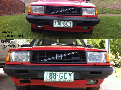

Thanks for all the very helpful advice pettaw! It will come very useful indeed. :D I've not been able to find any front panels or anything, but thats not suprising. I'll keep my eye out. I'll give it a go with the block of wood, and hope for the best, but I really would prefer a new panel I think to cover the empty fog light socket. Those lights never worked properly anyway, so I dunno whether I'll bother replacing it.
I found a photo I took of it when I got it, back in October 2011 (sorry about all my photographic updates if its annoying you BTW):
It sorta was a bit bent already, so this roo/wallaby didn't do anywhere near as much damage as I'd though. It was already pretty bent! :)
