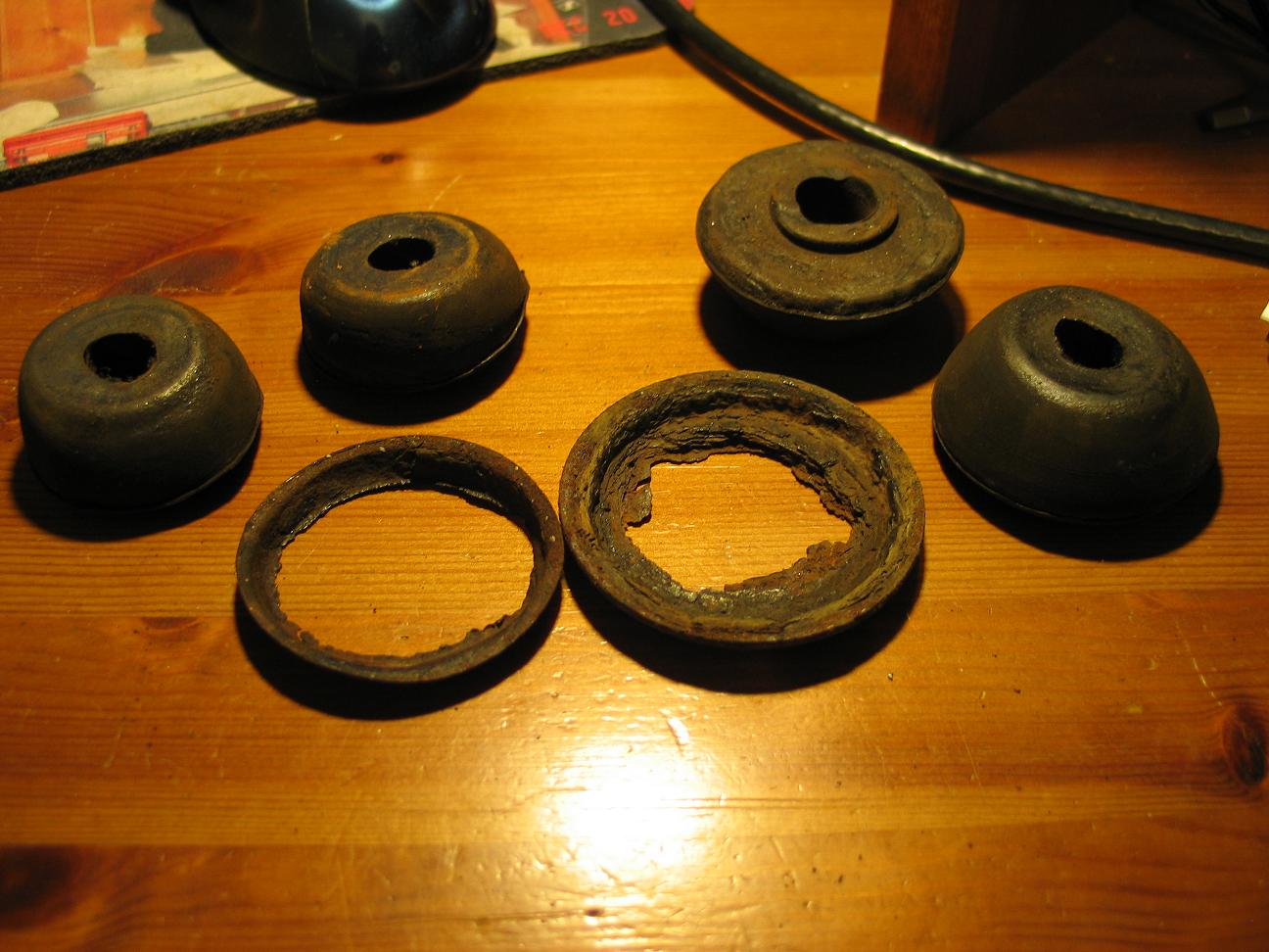

My bush cups for the front radius arms are fubared, anyone with access to a lathe willing to make them? Or any others also in need to justify getting a load made?
They can either be turned from a solid blank, or a press tool made on a lathe.
They are 2 sizes (inner and outer)
2mm thick blank washer approx 75mm and 52mm with 23mm hole
Inner hole slightly flanged to to sit in 30mm hole
Outer radius flanged

Anything any further on this? Just put new radius arms and polys on my car when i did the rest of the suspension and found that the larger cup on the near side was pretty much dust and could be moved by hand. Needless to say i get some clunking noises when braking hard or turning left sharply or hitting a bump :/
Afraid i cant help make them with what tools I have but i can help with pennies if i could get some repair parts

Well I'm still working on, need to get it sorted. I think the large one might be best made by turning as its quite thick material (2mm), but the smaller one is about 1.3mm, so I'm thinking of making a press tool, although this would be my first attempt. Will post designs for comment.
What I need is measurement of new bushes and/or good cups. The large one I have 1 good example, but the smaller one is more approximate, as mine are both knackered.
I'm thinking 45.5mm for the internal basin for the bush.
Incidently skateboards seem to use them but they are too small.

I'd definately be interested, both cups rotted off one side on mne a few weeks ago, luckily i'd just got another pair of mounts off liam, but would like to repair the others and have spares.
Are the cups actually separate peices or like a tube thats been pressed from both sides of the mount? i've not seen mounts in good enough nick to tell
Re: Radius arm bush cups
The cups are separate pieces that are spot welded in 3 spots. The middle hole looks like its welded or pressed together (cup hole is smaller than the mounting metal with a 2mm overhang) but it might just be formed during the cup pressing out for centering purposes.
