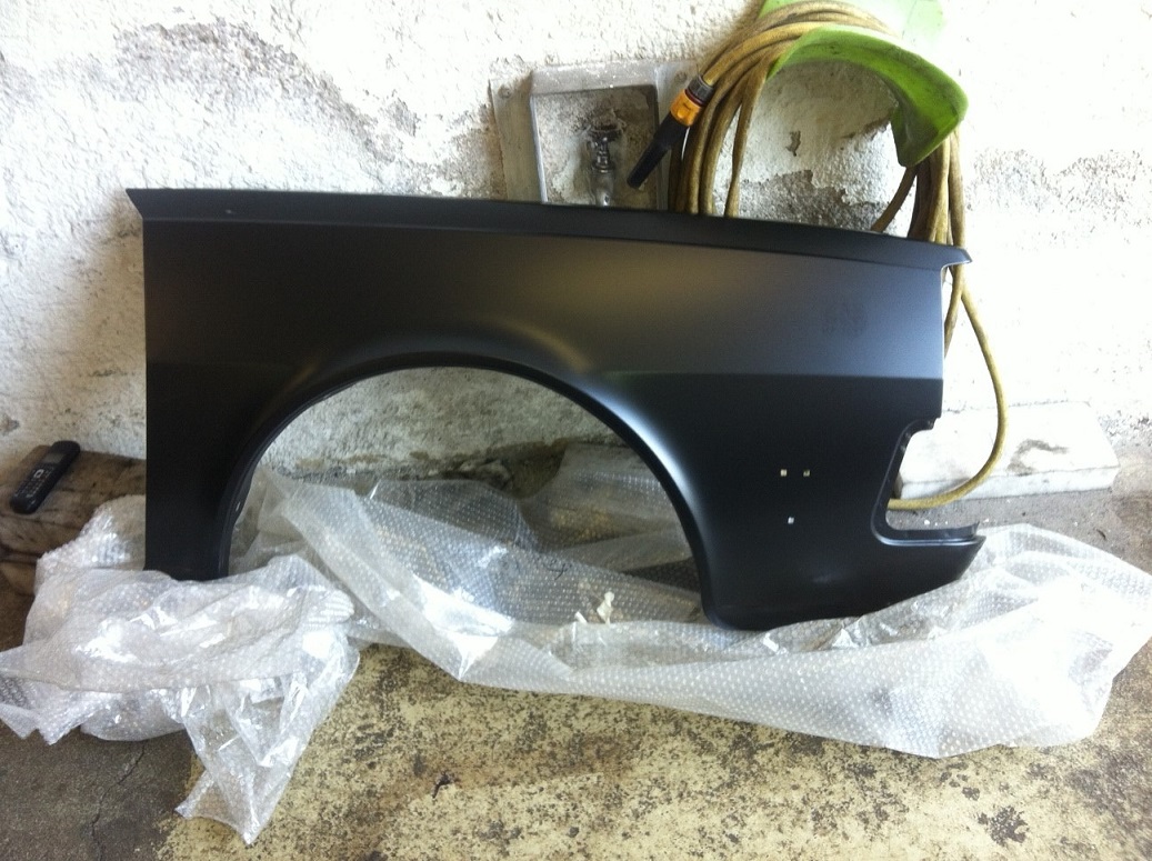

The 360 only has one serious spot of rust: the lower part of the right front wing. So today I took it off to replace it with the new one that came with the car.
Unfortunately I also discovered some serious rust on the inner wing.
You can`t really see it in the picture, the lower part is dissolving. Part of it will have to be cut out and replaced. But hey, if that`s the only part, I don't care too much.
New one is waiting:

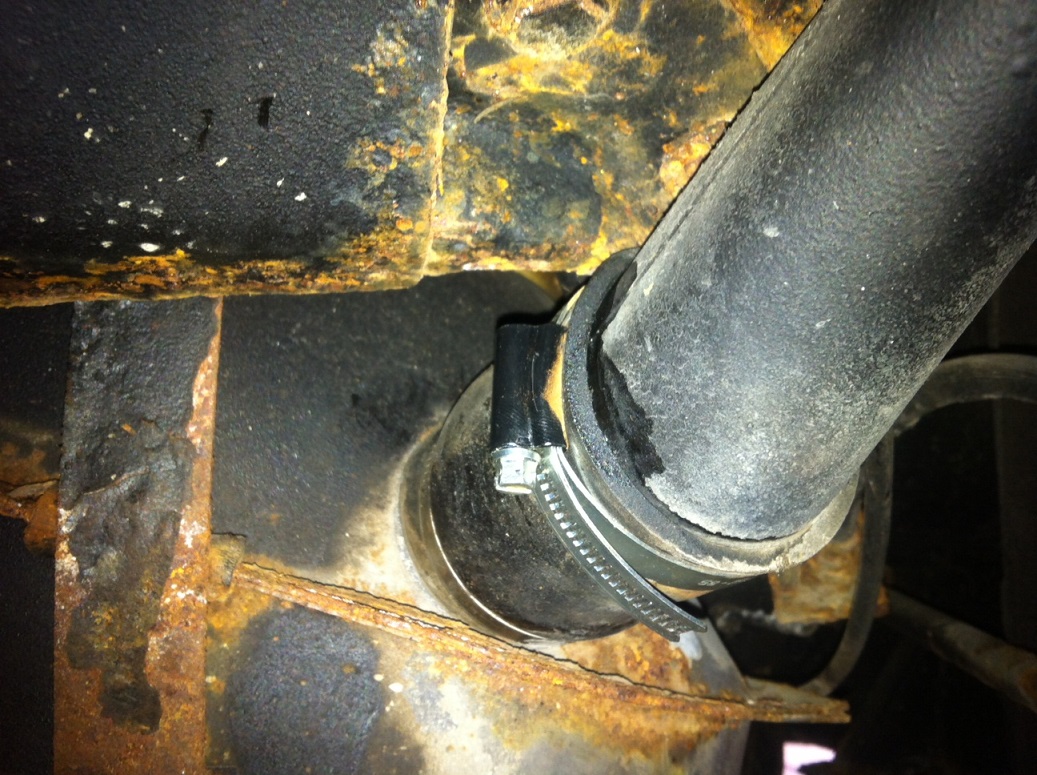

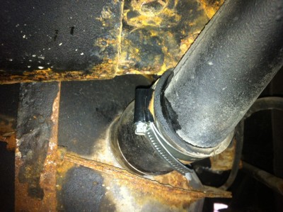

The left front wing also came with the car, but there`s no need to replace it at the moment. I also checked that hose between the fuel filler and the fuel tank. One clamp had already been replaced, but the other one was only just holding on. Replaced it. Thanks to this forum!
sm11

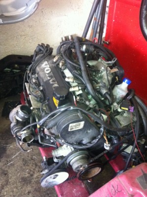

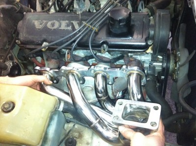

My mate had just received a parcel from Sweden for his 940. We seized the opportunity and fooled around a little...
But it`s too early for that - yet. First I want to see how the car handles on the Nordschleife. If I like it, this lump will be fitted later this year...much later:

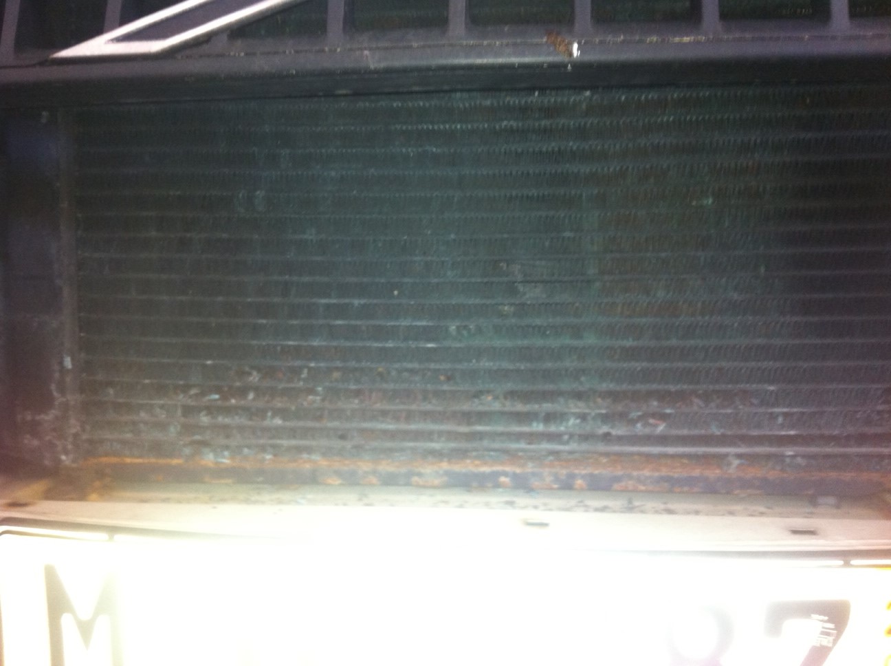

But before that I will have to get a new water cooler... I could get the fins out easily by caressing it with a brush...:

Does he know that he needs to cut the flange off that manifold and weld it back on the right way?
TheUglyDuckling
Posts: 44
Joined: 16 Jan 2013 02:43 pm
Re: Project: Volvo 360 GLT for the Volvo-Trophy
Post by TheUglyDuckling »
He doesn't need to - its going the right way round into his 940.
We just tried out figure out where we could put a turbo in the 360. In the lower back doesn't fit - so we tried for upper front :lol:
Posts: 5471
Post by classicswede »
Your photo shows it in the right position for fitment in 2/7/9 series cars. They are made in China but for some reason the mistake has never been corrected.
TheUglyDuckling
Posts: 44
There are two nearly identical exhaust manifolds - one is indeed an upper front mounted turbo. It is supposed to fit 240/740/940. But the one in the pic is the other version - "Turbogrenrör Turbo bakåt och neråt". Fitting only 740 and 940. Unless they send the wrong one.
Interestingly his manifold is 40 € cheaper then the one I think you are referring to - though it looks like just a flipped version. Maybe the wrong flanged ones were just the cheaper lower back ones - send by mistake or a desire to increase the profit?
Posts: 5471
It is the 240 one I was thinking of.
Are you going to be keeping the LPG system that is on the engine? Looks like zavoli pan injectors or maybe Magic jet with AEB wiring loom and Flashlube system installed.
