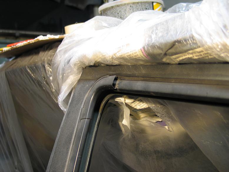

Well I was looking for advice on this and found this old post. No answers so I figured it out again, here are the photos.
Start at the top left (looking at driver door), this corner piece has a smaller catch than the rest.
Pop the bottom of first

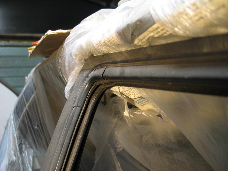

Then the top
Then the top

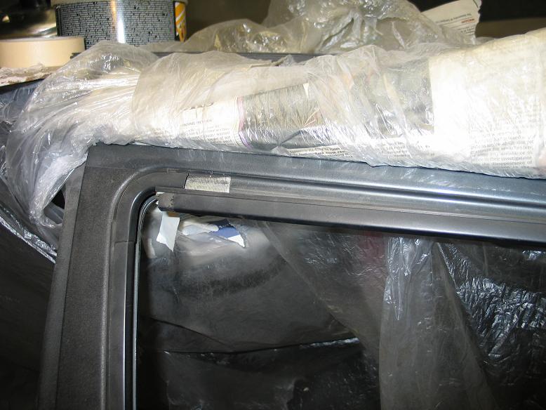

Move the top part down
The rest is achieved by a bit of wiggling and pulling.
