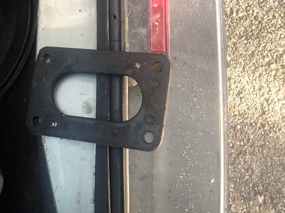

Re: 340 1.7 carb dont work!
This is the lower insulating plate - and known to crack!. If you fit one of the "green" spacer and rubber shim kits this lower plate is no longer used and can be dispensed with. (you will still need a gasket between the new block and manifold though.

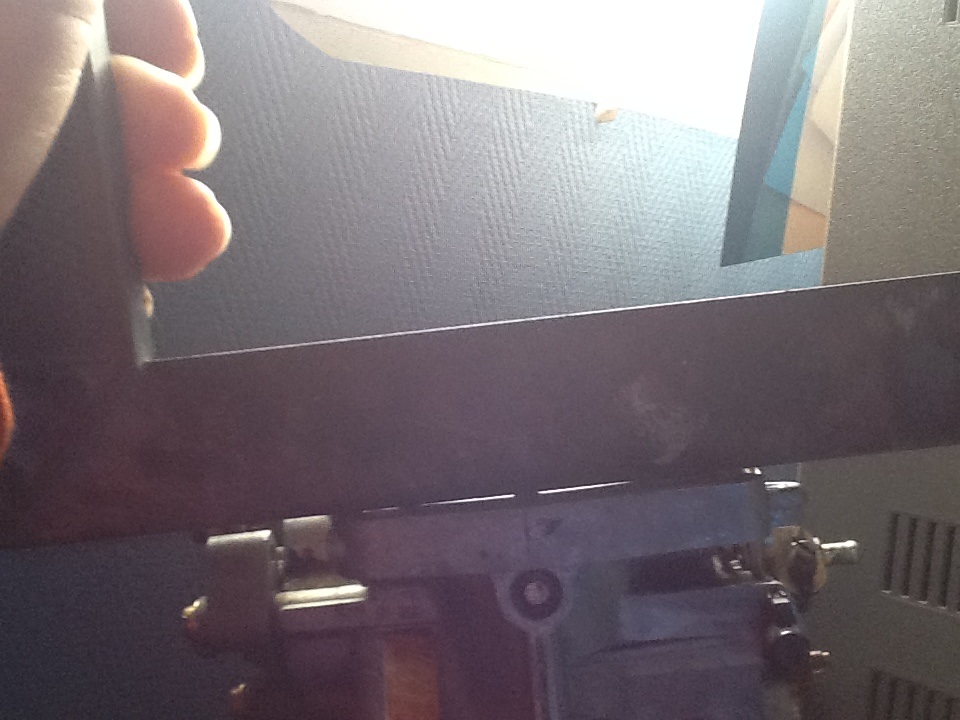

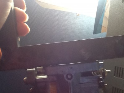

The base isnt totally straight, the hole is not big, but its caused by the temp of the engine? The green block dont deform with temp?? I use the car go to track, and its operate hot.. I go to fit it with new handmade by me gaskets and ¿¿luiquid gasket?? Its go to works? Thanks

As standard,
Carb sits on a black, thick, composite insulating block which reduces the transfer of heat from the manifold to the carb (reduces the risk of fuel vaporisation). Between this block and the manifold sits a thinner plate with a gasket bonded on each side.
Problem,
Heat and over tightening causes the base of the carb to warp causing an air leak between the thick block and the carb. Heat and time cause both the thick block and thinner plate to warp and often crack - again allowing air leaks.
Possible answers,
Reduce the carb distortion by sanding or machining, fit with good block and plate using new or newly made gaskets (I would avoid "liquid" gasket). If this cures air leaks all well and good.
Or, fit "green" block and rubber shim gasket - the rubber seal is designed to accommodate up to 2mm of carb warp. When using this kit the thinner plate from the std. setup is not used. You would need to make a gasket to go between the green block and the manifold and transfer the engine breather tube from the black to green blocks.
The need is to eliminate air leaks - exactly how is less critical but I would not make a replacement block from aluminium - this will promote not reduce heat transfer - if you use the car "on track" you would almost certainly run into fuel vapour problems.
Does this help?
Mac.

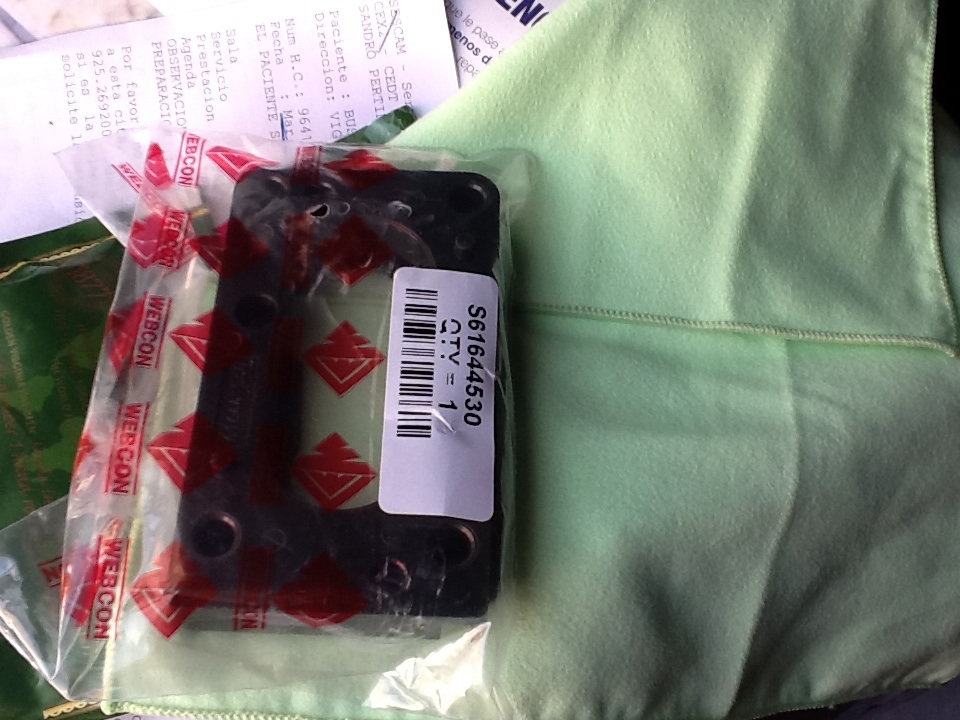

Yess !!
i email webcon to buy the green block. I think the same think abou aluminium but better a second opinion
A lot of thanks!! The green block is paid, now im waiting postman nesr the door all time!
