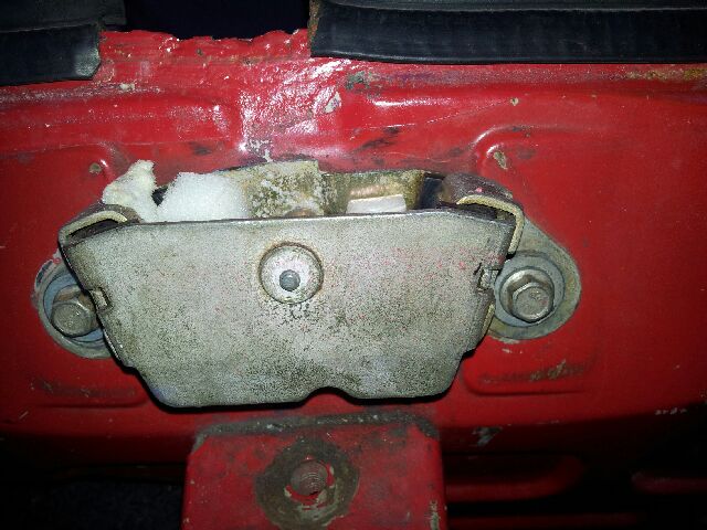

Hi all, mine is so knackered that my hatch rattles over every bump. I checked the main bar going across and that has a big groove from the wear and tear!!! Would anyone be willing to send a good one to Brisbane?

Kelvin, there is a bit of adjustment in them if you haven't found it yet!

Volvomania...contact me if there is a good one....one that does not have a grove in the underside bar!!

The two bolts that fit it to the shell are slotted, so you can take up slack as it appears with both wear to the catch mech and as the rubbers loose there bounce. Fakes was awful when I got it!

yea but in saying that you have to close the boot that bit harder.

just checked my spare to find it had tape wrapped around the bar. do you still want a price? I suspect it may have the same issue.
