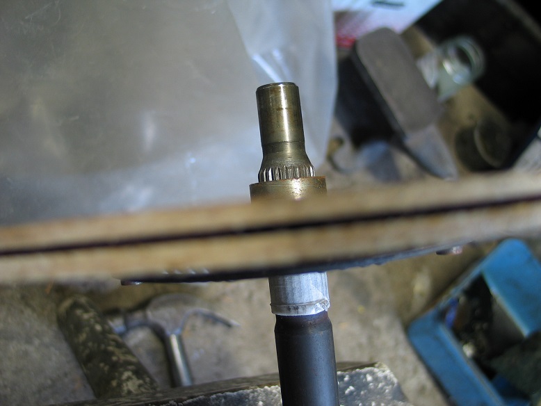

I've also noticed the (360) pilot bearing does not fit the 360 drive shaft, does it only just touch it or does it need rammed in? I did move the driveshaft in the torque tube, does it need to be precisely located? Would seem to be a strange design.

-Check fitted the drive and clutch disk - the pilot bearing does fit the prop shaft, its just a tight fit, and the flywheel is shapped appropriately for the 360 (it does have a similar outer step as the 360 flywheel, just not identical).

Original disk centered on the splines length
215mm 360 disk.JPG (119.99 KiB) Viewed 327932 times
removing the Disk to see to position pushing back again the masking take, note collar difference
228mm audi disk tape.JPG (96.89 KiB) Viewed 327932 times
The Audi disk collar is slightly further up the splines but is still getting full engagement so should not be an issue. Plenty of clearance to the pilot bearing.

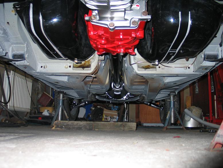

Got the pedals and box sprayed up, brakes all assembled, struts assembled with all refurbed parts. Steering rack, cleaned and sprayed with the new(ish) crossmember. Added a modified 940 jacking plate and some strengthening
Internal rust proofing done, used Rustbuster Mil spec and got about 3L in.
Bulkhead sound proofing mostly done, got the ventilation and controls module back in with the rebuilt engine bay vent box with a Mac special fan module and pond filter.
Got all the big heavy stuff in now, nearly finished Engine mounts and about to tackle wiring.

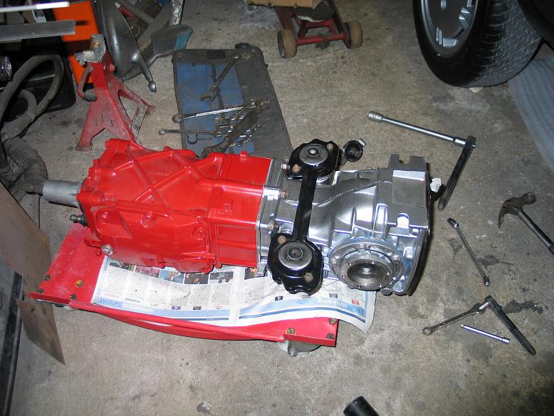

Gearbox and diff with strengthening brace

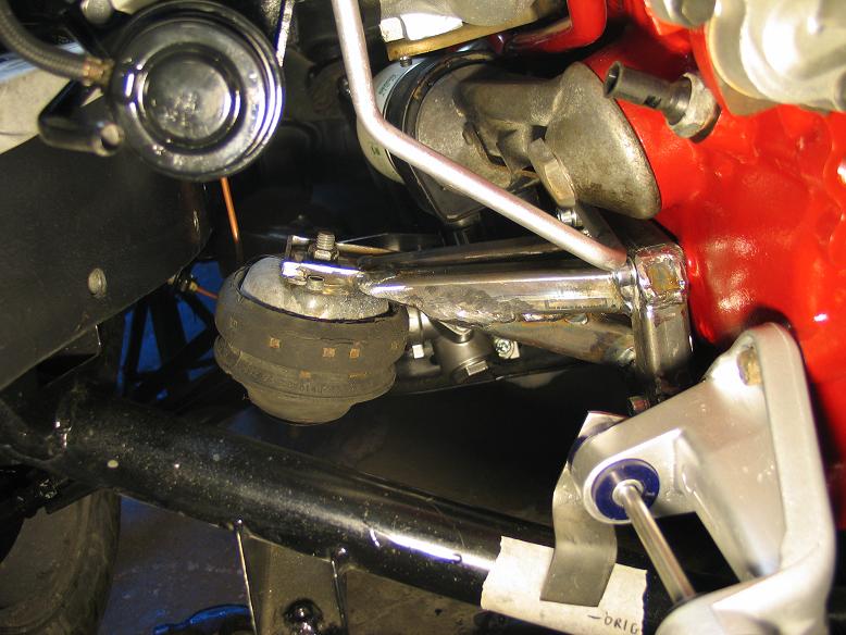

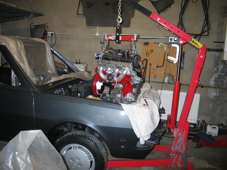

Engine in on standard mounts
Underside drive installed
940 Engine side mount decide not to use

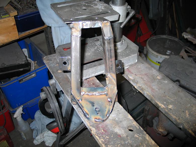

Custom Engine side mount
Chassis side mount
Chassis side mount

Looking pretty fantastic it has to be said! What sort of turbo clearance will the engine mounts give you? A friend had a 360 with the original B200E+T with standard mounts, 90+ manifold and a 13c and it was very tight. Are you sticking with the 13c or going for something like the larger 15G/16T? I'd go for one of the latter unless you already have a decent 13C as it shouldn't really be much more work.
Re: 360 turbo saloon tidy up
Posted: 29 Apr 2015 01:28 am
by Ride_on
The 13c was already good but got it checked and refurbed with new seals anyway, they even sprayed all the bits individually, so looks nice. I don't want it too unreliable, I'll see how it is once I've maxed out the 13c. I'd actually like to prove a point that you don't need a bigger turbo or that bigger is just more lag (or disprove as the case may be). I want to log charge temps, pressure and so on.
The mounts give more or less the same clearance as the 940, there is just a 3cm offset towards the driver on the 360 as its mounts need to avoid the front beam/ARB mount. I think the 940 engine side mount would work, but it would need a funkier chassis side mount as it would be forward of the 360 bolts positions. The closest part is the water pipe has about 5mm to the mount corner as it goes over the edge of the chassis leg. That could be rerouted if necessary, but it won't hit it rotationally, the engine would have to move 5mm sideways. I'm trying to reuse Volvo Engineering as much as possible, ie keep the 940 Turbo oil drain and engine mounts. Still a bit concerned about oil squirters and 360 oil pump capability.
