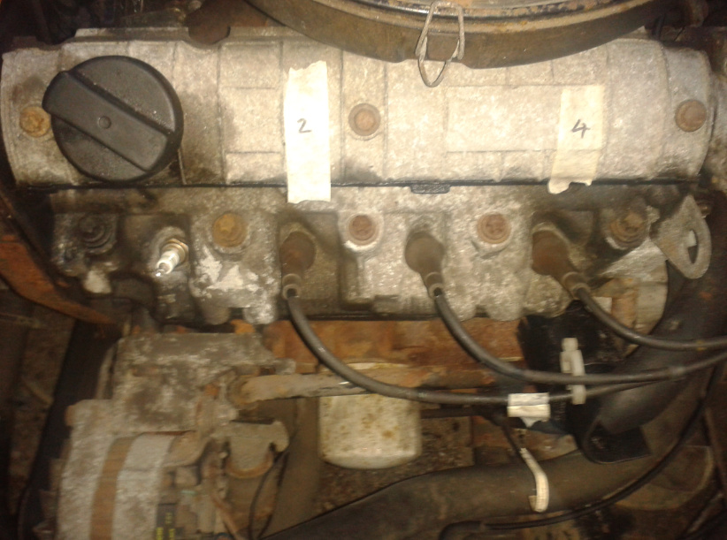

340 1.7cc, B172 engine update Part I:
1) Fitted a cleaned set of spark plugs -old plugs clean but I broke one on removal
2) Cleaned rotor arm but couldn't pull it off the distributor
3) Cleaned the HT leads; two of the metal connectors were dirty & two small metal bits were broken resulting in quite a loose connection
4) Two of the plug end HT leads rubber connectors are bent & make for a loose connection on plug 4
5) Cleaned distributor cap - very fouled with crystalline deposits
6) Cleaned battery earth strap & all connections to earth at battery & to engine block
7) Petrol seemed to have evaporated (over the last 7 years!!) so put in a 5.5 litre jerry can
8) Heavy crystalline deposits around thermostat / hose inlet (just below distributor); removed rubber hose; end of hose & thermostat housing inlet plugged full of presumably crystallised coolant; cleaned this out as best I could & drained out coolant from radiator & refilled coolant system.
Part II:
1) Turned engine manually with ratchet - so engine is not seized
2) Had ignition lights on dash after a battery charge & electrics were working
3) Engine turned but weakly so I knew it wasn't going to start
Part III:
1) Got my old Fiesta (also off the road!) working, pulled her out of the garage & connected jump leads to the 340
2) 340 turned over strongly but didn't fire - but I knew I was on to something!
3) Turned choke on Fiesta up to very high revs - 340 FIRED UP FOR FIRST TIME IN 7 YEARS!!! :340:
4) Kept her going for about 25 minutes but couldn't get her idling without choke (see "Things Wrong with 340" below).
The day I got her started was 28th December 2014. According to my records the last petrol I put into her, with her on the road, was 25th October 2007. Her last tax expired 30th November 2007; so it's a definite 7 years without starting / use.

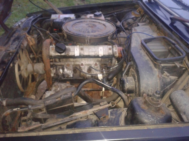

2) Engine not idling properly. When I got the car started, because the choke cable is broken, I manually moved the choke on the carb. When I fully closed the choke / carb flap, the engine started to stall; the engine was warm, the coolant radiator had kicked in, so ideally it should have idled without choke.
I'm not happy with how the air filter housing is sitting on the top of the carb; I'm not sure that the three bolts are aligned properly in terms of their respective heights - so I am guessing that there is an air leak there - this could account for the non-idling without choke. I replaced the original carb in May 2006 & it passed the MOT emissions & functioned perfectly until I took the car off the road in Oct/Nov 2007

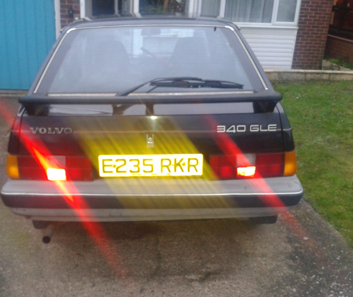

3) Reverse lights not working. Cleaned connections, fuse ok but no joy - there is some rust / moisture just above the delivering wiring to those lights (nearside rear) but the strange thing is is that the other lights in that unit (side light, brake light & indicator) are working so for me the delivery wiring is sound.

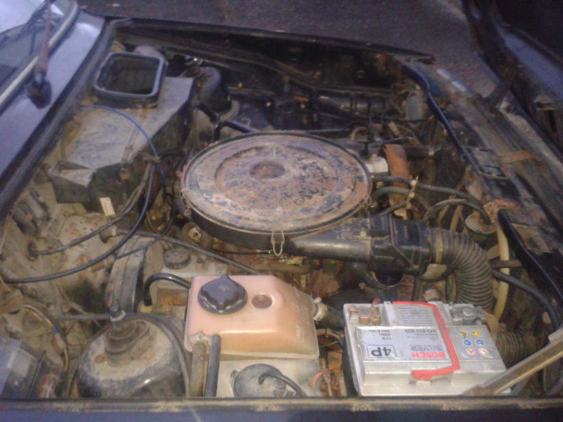

7) The battery housing plate is badly rusted at the coolant expansion tank end. Pretty sure that's an MOT fail. I have been monitoring the coolant level closely & so far I believe that the coolant expansion tank is sound / not leaking.

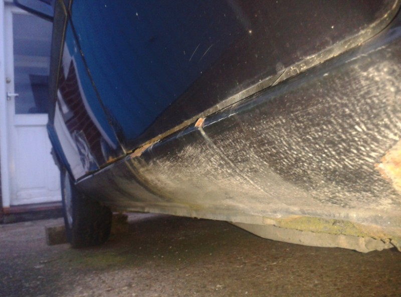

8) Driver's side, rear passenger door sill rusted - maybe 3-4" rust hole developing - didn't want to prod it too much as yet. Again, pretty sure that's an MOT fail

11) Engine bay looks a bit rusty - can't see any obvious rust holes - hopefully fairly surface rust that can be repaired

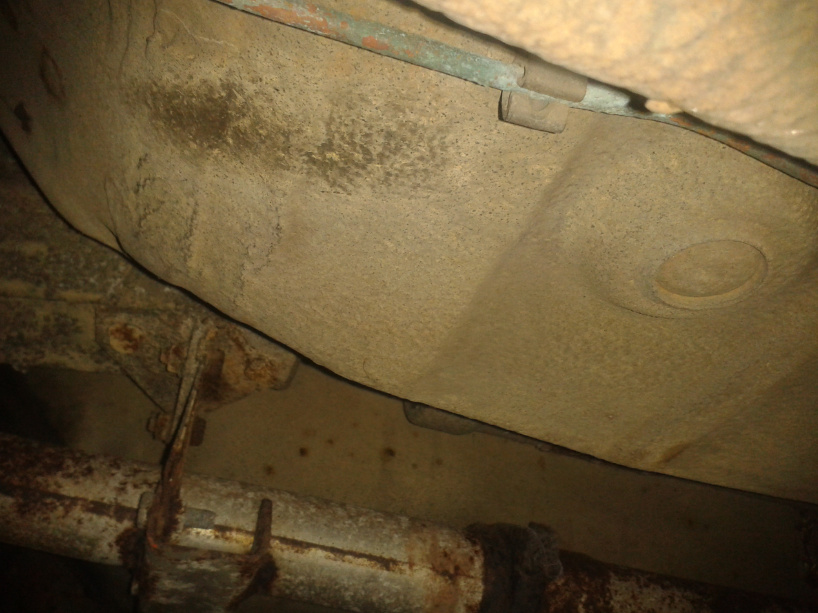

The sills look good and, as far as I can see, the underbody is good; rear, roof, bonnet & wings all look pretty good, as does petrol tank. All glass is good apart from windscreen chips but didn't fail 2006 MOT. The electrics all seem to work apart from the electric windows, reverse lights & central locking. Handbrake seems good but I would imagine that, after 7 years with no use, the entire brake system would need a major overhaul - new pipes, discs, pads etc. Can't be sure. The brake pedal seems to function normally. I've never worked on brakes - it's one of my weakest areas of knowledge.

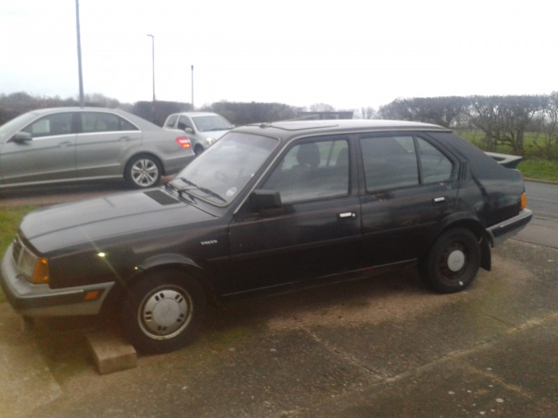

These are the pics. Let me know if you need more.
