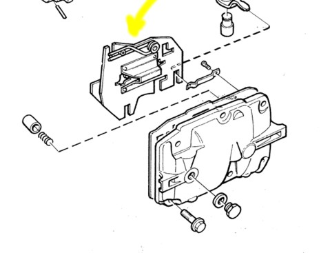

Many thanks. Is this it??
Re: Another gear lever question.
Post by volvodspec »
yes that's the spring
