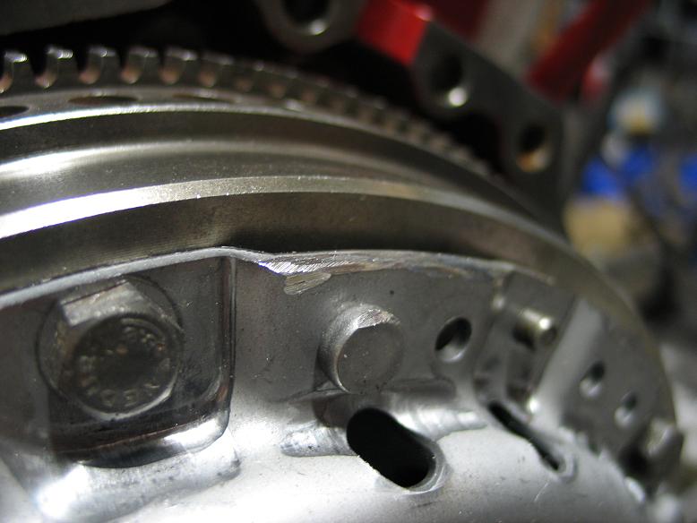

You can use various clutch pressure plates, different ones give different holding pressure. You need a friction disk that matches the 360 drive shaft. The 360 disk is only 215mm but the rest of the parts are 228mm, so the Audi disk is 228mm and fits the 360, or any B2xx solid flywheel.
All solid flywheel 200/700/900/360 use similar clutch cover, but the 360 one is a bit flatter at the edge to fit the bell housing. You can just grind down the edge a little for one designed for the bigger bell housing.

I just ground down the corners at the edge of the clutch.
Sach 763 modification

I have seen that flywheel and I think it needs a different computer system than the Bosch EZK, I'm not sure yet how critical the pickup is.
Mine is a 940 solid flywheel (almost the same as the 360) for Bosch EZK ignition.
