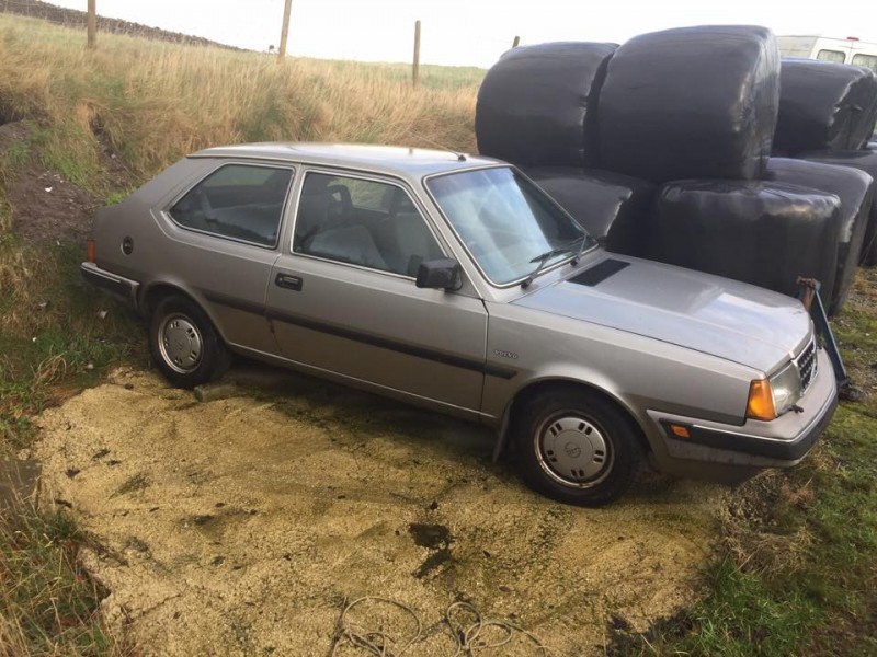

Just viewed the car today and put a deposit on it. The body work was in great condition, sill and underneath near perfect. There is a bit of rot on the front bumper where it has been knocked by the looks of it.
Only issue i was woried about is, pretty sure it seems to be leaking fuel, from near the tank. Smelt pretty strong as was signs on the floor. Also looked like gearbox/diff may have a leak. Are these common issues/something easy to fix?
Anyway, it drove sweet, started up perfect, and idle'd perfect.
Picking it up for 325, no mot, reasonable or not? These seem hard to come by. I am sold by how good condition the body work is in. Cheers guys
