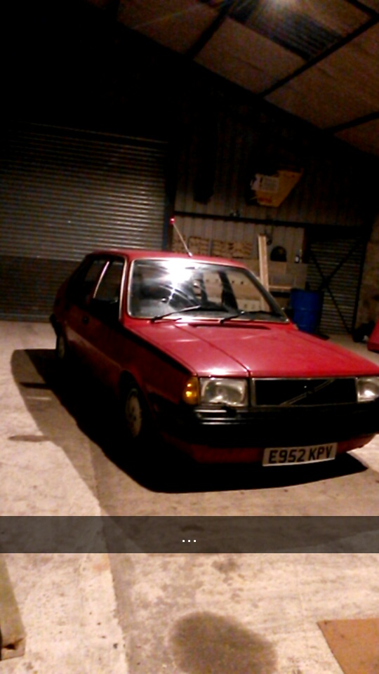

Hi all, im oli, im new here, i tried posting an introduction but it wouldnt post for some reason "/ anyways after years of wanting a 340 (even tho i drive e30's lol), i have one, and ive found myself a cheap 2003 clio 182 but i dont want to buy it without knowing exactly what im in for! Other than having the ecu de coded to do away with the immobiliser can anyone please tell me what other problems i might encounter as i know this would be a bit different to the usual f7p/r swap. The car is a 1.4 so i am aware i would need to get hold of some 1.7 bits. Thanks in advance guys
