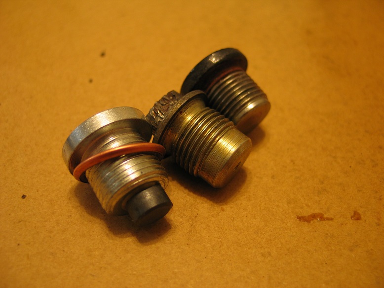

Yeah they are 18x1.5, same as the drain and diff filler plug.
Gearbox filler (middle) and diff filler plugs
The gearbox filler is a little special with resessed shank above the thread and a tapered flange, but I used the simpler diff filler type with a large round section washer. Seemed to seal ok but its not immersed.
Would like to get more appropriate ones
