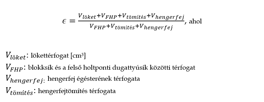

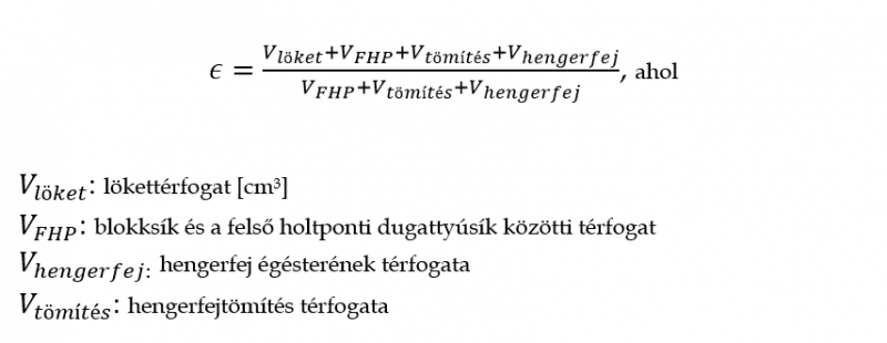

I managed to measure the volume of the combustion chamber. It's 48ml +/-2ml.
There is only one data missing from the formula. The volume between the block plane and the piston at TDC. I assume it's zero. Can anyone confirm this?
The formula what I use (in Hungarian)
V löket - Volume of stroke
V FHP - The missing volume
V tömítés - Volume of the head gasket
V hengerfej - combustion chamber

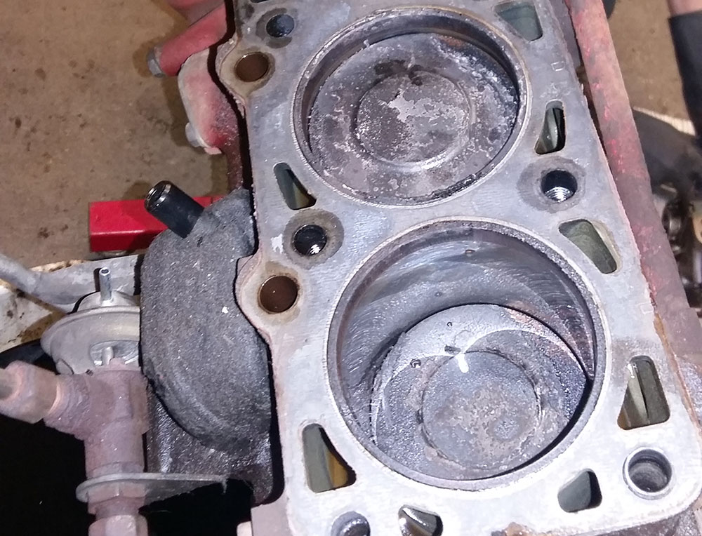

Re: speciale 25 glt+T

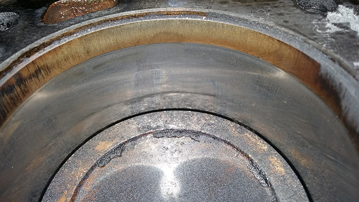

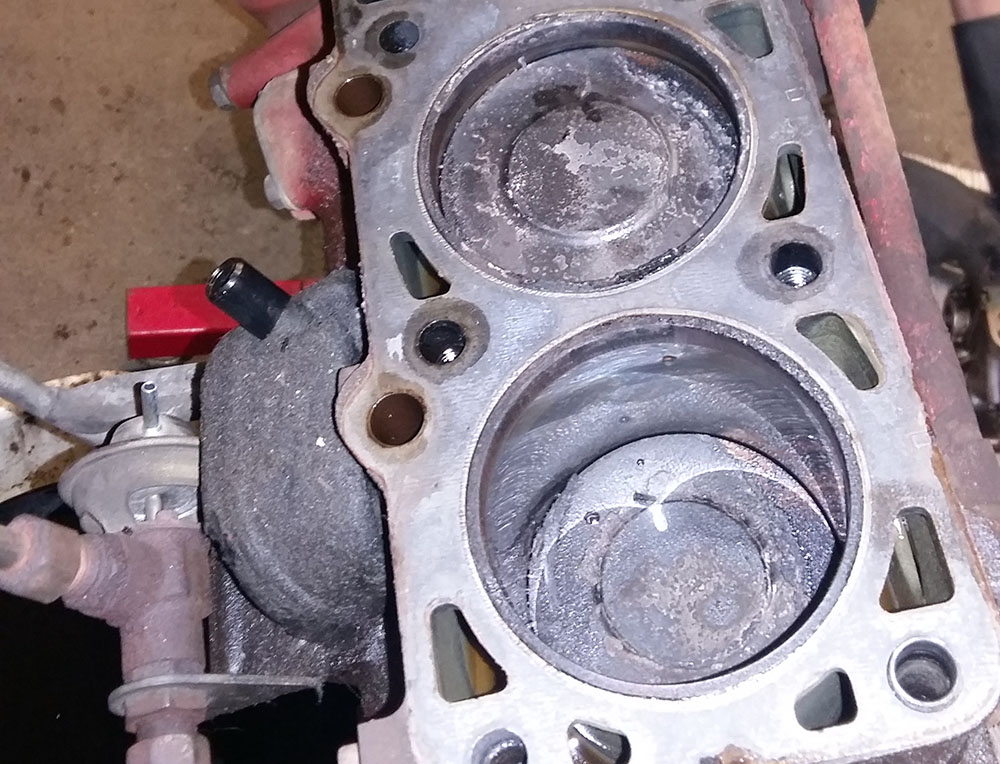

Hi There,
Now the engine is out of the car, and I've a few questions.
First of all, Is it possible that the factory used double head-gasket originally?, Shouldn't the piston be plane in a B200E?
Thank's!
Thank's!
The domed pistons I believe were fitted to the higher compression ratio cars, prior to 1987-ish? Perhaps the bottom end has been changed and the second head gasket added to lower the compression ratio? I don't think it's at all likely that that dual head gaskets were fitted from the factory.
I've thinking in a similar way, about the pistons. The car is manufactured in '86. Most likely the machanics used the double gasket to compensate a previus machine work on the engine-top.SteveP wrote:The domed pistons I believe were fitted to the higher compression ratio cars, prior to 1987-ish? Perhaps the bottom end has been changed and the second head gasket added to lower the compression ratio? I don't think it's at all likely that that dual head gaskets were fitted from the factory.
But I had an another maybe dumb idea, that they use the double gasket in the factory to compensate the high compression pistons. Cause It's a Swiss market car, and at the time there was pretty strict rule for emissions.
I think that is the reason as well, why the engine has a complex, but rather wierd crankcase gases return system on it.

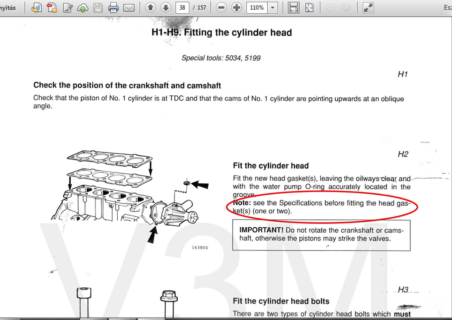

UPDATE!Gabor wrote:SteveP wrote: But I had an another maybe dumb idea, that they use the double gasket in the factory to compensate the high compression pistons. Cause It's a Swiss market car, and at the time there was pretty strict rule for emissions.
I found evidence that it might be a factory soultion
I remember reading somewhere the double head gasket was for low octane fuel ;-?
