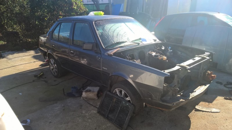

the car...bought for 190€ plus 25€ towing fee and sold the engine for 125€ - current cost 90€ :)

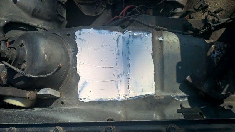

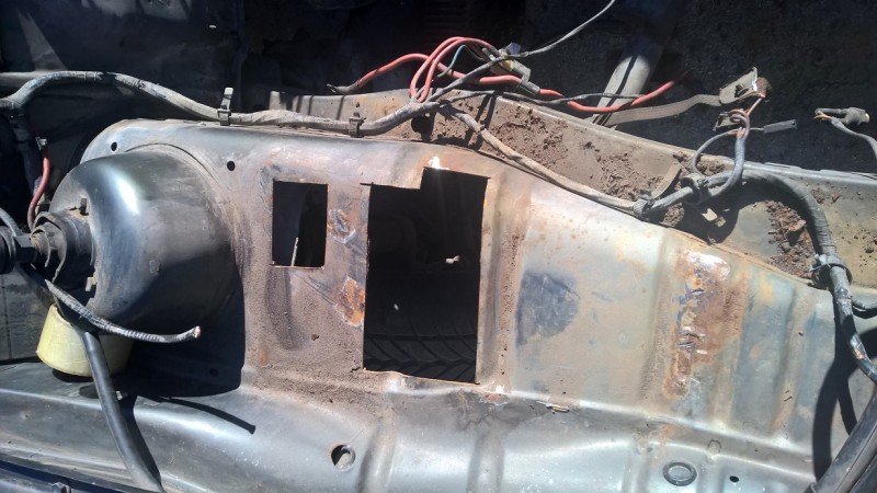

first job was patching rust holes...it was my first time mig welding , only knew how to weld stick
2
2
3
3
betume
betume
final
final

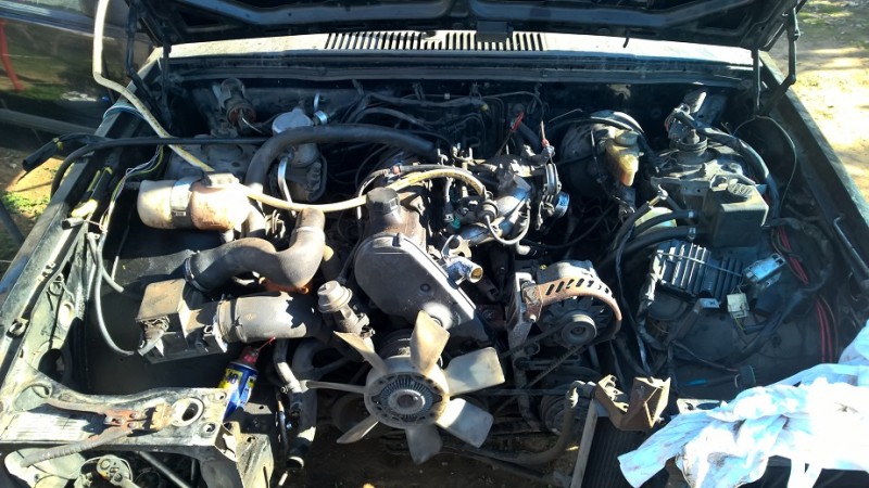

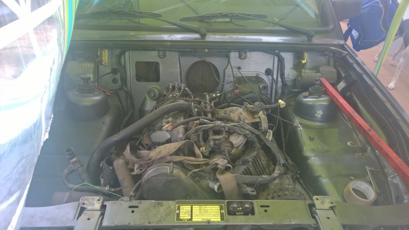

yesterday i was bored and pressure washed the engine bay because it was filthy and now it makes me more motivated to work on it :)
this is the donor 740 wich is also mega-filthy but runs good
the weird propane hoses are for a temporary fuel tank and pump i installed to test the engine because the original was rotten and the pump seized
440 motor
440 motor

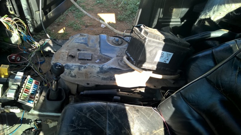

this is a mitsubishi colt fuel tank as temporary tank to power the 740, pressure is 3 bars
later i will use the pump assembly and internal swirl pot and fit it into the 340 tank along with a walbro pump
tank
tank
the loom i trimmed to the essentials and tested the engine if still runs
now with a schematic i have i will redo it entirely with the old one by my side and the schematic to stop me from making mistakes
engine is out and its filthy
has a leak on the oil pressure switch and on the turbo return line
it leaks gasoline into the oil so maybe a clogged injector or the cold start injector seized open
now i have good and bad news
good news is the rear axle from the 740 is almost the lenght of the 340 so it will fit,although i have to redrill it to 4x100 on a machine shop. i will use the rear disk brakes also
bad news is gearbox wont fit the 340 tunnel..i will try to bash it but i will probably have to strip the interior to widen the tunnel sm2

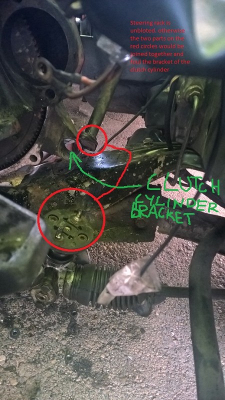

the steering rack fouls the clutch cylinder, i then removed it temporarily
mounted the engine without sump but the oil pump fouls the steering rack and its impossible to relocate the rack, i could mount it further down but it will hit the floor on a bump.
no matter if i place the engine close to the firewall or all the way to the front the problems remain
now my plan is to cut the sump to clear the rack,it will barely clear but i have to cut a big chunk of it, then make engine mounts and deal with the clutch later, but i may get into trouble, also i would prefer to have the engine all the way to the back close to the firewall i think the car would handle better.
my head is boiling and i cant find a solution, i have no problem fabricating but i cannot think of what to fabricate on this case. the oil pump is drive by a shaft and its impossible to relocate. otherwise i would simply flip the sump and make a larger pickup pipe.

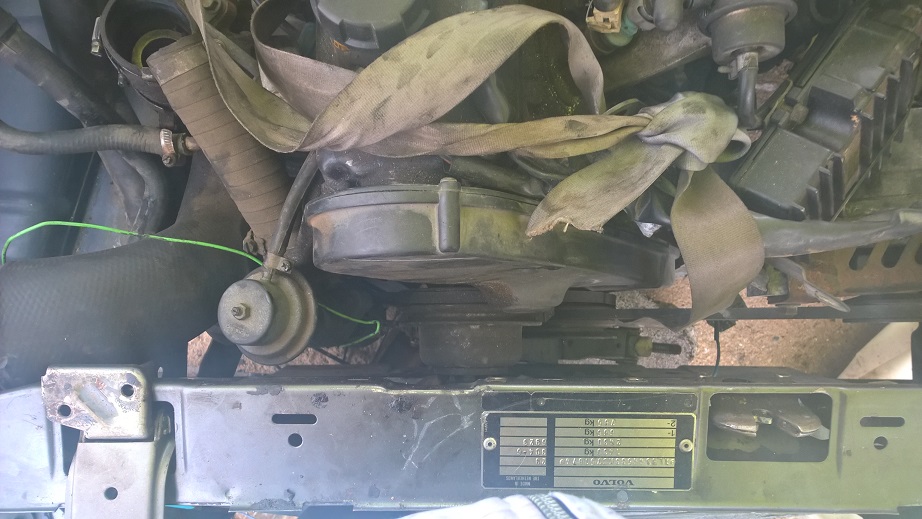

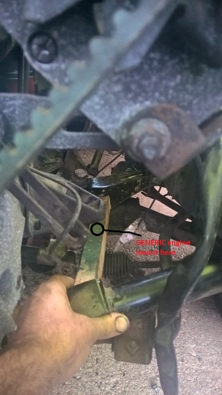

engine is mocked in place with some blocks of wood
engine mocked in place
front clearance looks like this
the mechanical fan will go to the junk
rad clearance
rad clearance
clearance from the turbo to the chassis rail
looks ok to me
turbo clearance
turbo clearance
steering rack is unbolted because it fouls the bracket of the clutch cylinder
rack problem
rack problem
for the mounts i will weld this piece of tube like this and insert a generic engine mount, those cylindrical with a threaded rod on each end
mounts
mounts
please any ideas are welcome before i screw up further :)
