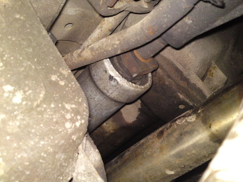

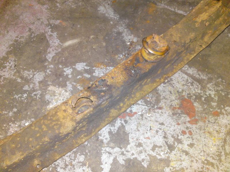

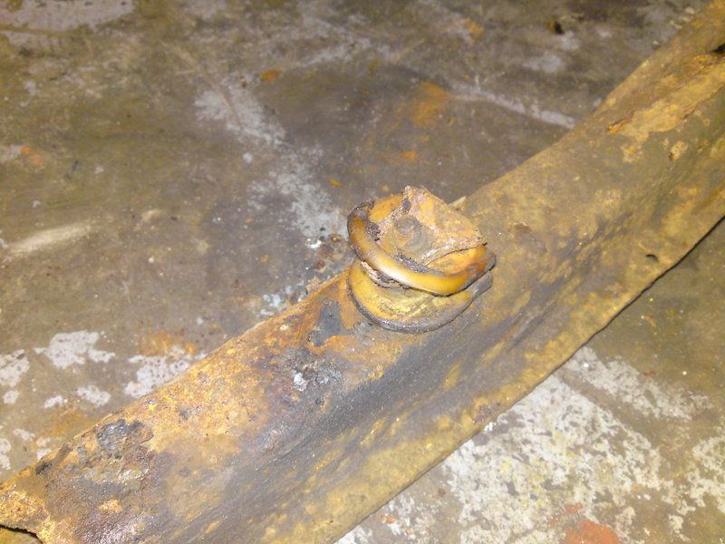

Mine was from all accounts solid, until yesterday. Pulled out of a junction at low speedand heard a noise like prop coming off, although just about still had drive but only just, so pulled over and looked under car o be greated with the back of the gearbox 10mm from the floor, rear crossmember had rotted enough to allow the bolts from the bush to be pulled out on one side and to pull the bush from the box on the other side....

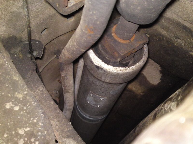

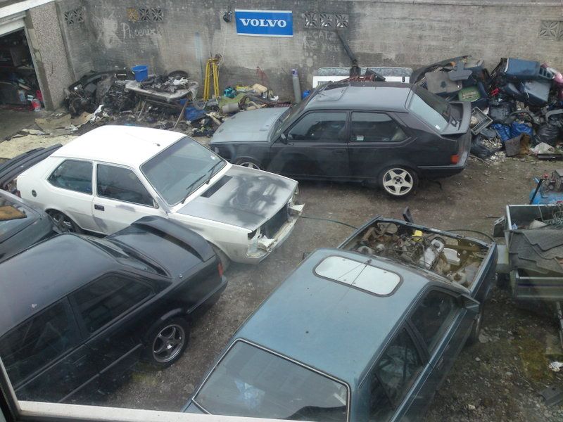

Well first two shots show whats left of the crossmember, then damage to prop, and last pic is current view out of my study.......
Adam
Adam
Re: Please check rear gearbox mounts on 340's!!! *Disaster!!!*
Woah dude.340GLT wrote: 2009/DSC00102.jpg[/img]
Whats that saloon in the bottom left.
Is there pics up anywhere?
Looks canny interesting.
Haha, its a secret, the bottom right saloon will be cut up and added to my T5 project....
Bottom left is an E30, 316 with a 1.8 e21 lump in it, for sale if you want it....lol
Adam
Adam

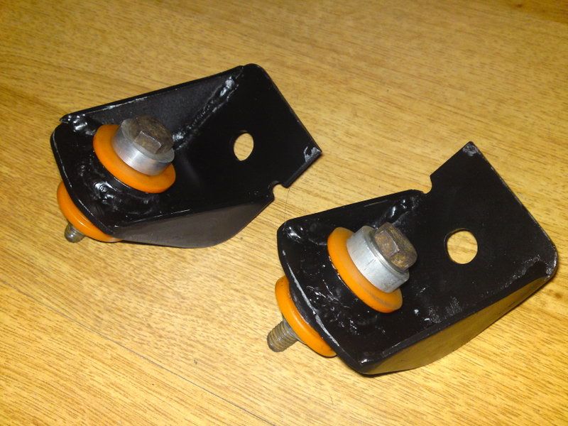

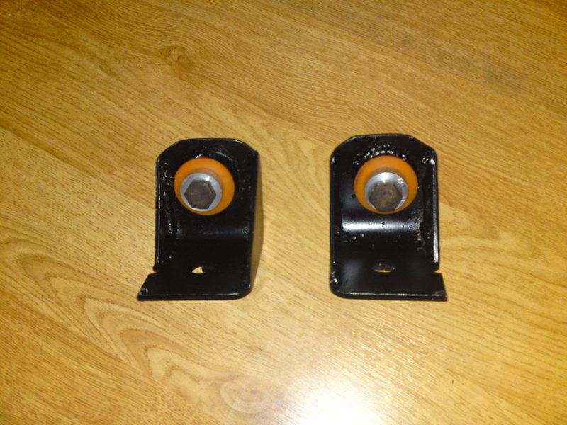

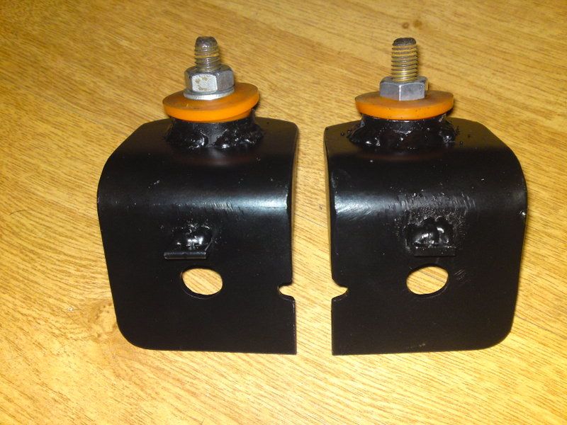

Right here is my solution to the rear crossmember problem. Some 340 gearboxes have the holes in the side of the diff casing to accept the 360 rear box mounts, mine didnt but you can easily drill and tap the holes, with that done i saw the 360 mounts as a better design, however bushes in mine were knackered so i made these, poly bushes in a steel tube welded into a plate i made. Plate is made of 3mm mild steel, i then turned up a centre out of aluminium to support the bolt. This will then bolt to the diff casing and then up to the 360 box mount.
Oh the chassis of a 340 doesnt have threaded holes to accept the 360 mount, so i drilled through the pilot holes that are there and bolted up through the boot floor.
Hopefully refit later.....
Adam
Adam
well of course i want it dude. Its black, shiny and mysterious.340GLT wrote:Haha, its a secret, the bottom right saloon will be cut up and added to my T5 project....
Adam
Fortunately (for me), I cant afford it. Couldnt Insure it, and couldnt handle it.
Otherwise id be one happy dead body.

That looks like a neat solution Adam. I can't remember the 360 mounting, but do those 90 brackets attach the box straight to the floorpan, without the 2ft long girders?
- 340GLT
- Posts: 3657
No they bolt to a similar style crossmember but its bolted in by 4 bolts not 2 so thats more of a csa and its a sturdier crossmember.
TBH the main reason for doing it this way is i dont like that if one rear bush on the 340 fails the box can drop, that not possible with the 60 mounts.
Adam
