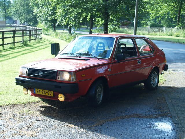

Im making big progress on my project car, so i'd love to show you all my little (not so) shiny 343!
Bought it from Jack vd Bergh, the guy that started the V3C with some help of other people. It was a 77 with all sorts of gadgets. B14.0S motor on LPG, variomatic offcourse.
Then I had the Idea to put a 16v in this car. Hadn't been done a lot back then. And started with a donor clio. Due too being a student ($$$) and having little time, this project has taken some time...! Last summer I made the time to put the engine in the car, and only till now I have the time to finish this project. During time I switched from making it a fast daily into a trackday/drift car...
