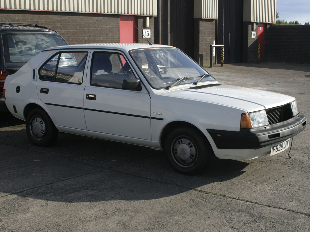

Hi so as promised, Iv started my thread. Should probably come under the "Beginner" category because Im just doing basic stuff.
02 car.JPG (200.28 KiB) Viewed 78753 times
while doing bumpers

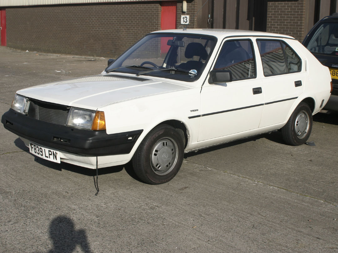

03 volvo.JPG (167.41 KiB) Viewed 78753 times

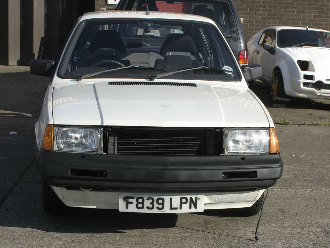

04 old wheels.JPG (187.84 KiB) Viewed 78753 times

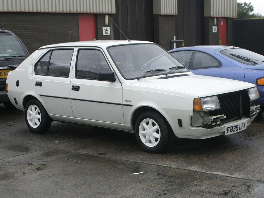

05 new wheels.JPG (167.22 KiB) Viewed 78753 times

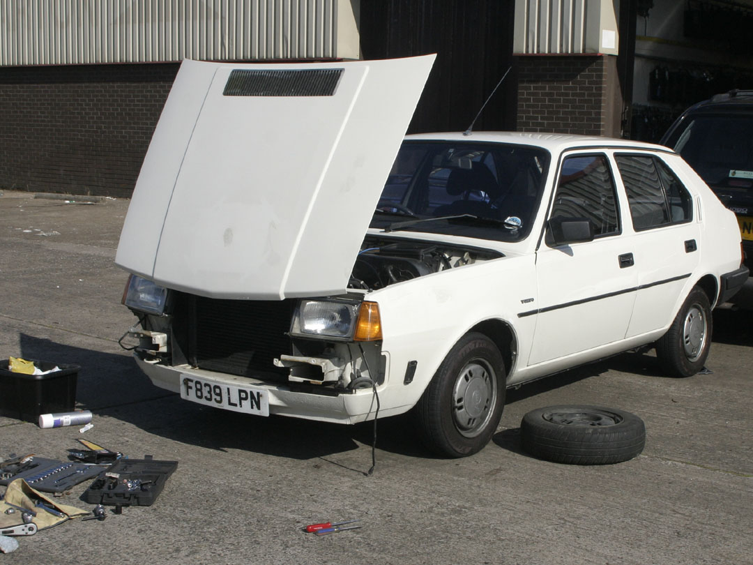

06 typical much about.JPG (185.54 KiB) Viewed 78753 times

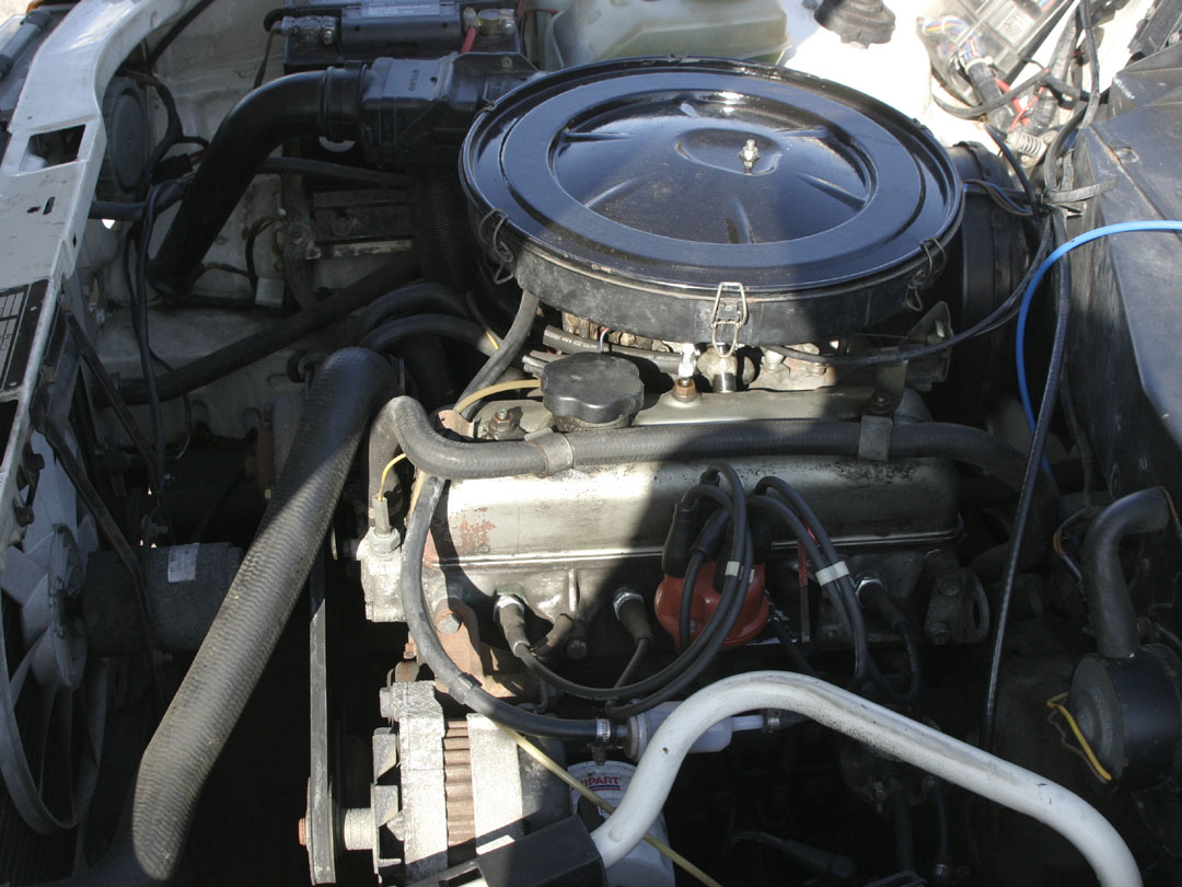

Original air filter

Cant wait to drive it again.
Taking the bumpers off meant I couldn't for the last week but I think I'll bring it home tomorrow night :D
Im most surprised by the K&N, I haven't touched anything on the carb. Just made up an adapter plate, fitted the filter and started the car! The Performance is fine so far. It started better too!
Oh, and I'll take the blue plastic off the filter tomorrow too.

Nice work. What sort of work was the adapter plate?
Re: White 340 Mod thread!!!! Some photos
Posted: 22 Jul 2009 12:42 am
by mrsoundcraft
Everyone that's seen it has remarked that it is very clean and rust free for a 20 year old.
I should hope so though because it cost double the price of my daily driver! I does have a few patches that have been touched up by the previous owner, Glasgow Jim, who was a member on here, and there are some light dents on the n/s rear quarter, so I dont feel like Im wrecking a classic.
Now to the adapter plate :D .
I used a sheet of very thin aluminium, 2mm at most.
Firstly I cut it to the same outside shape as the K&N filter, Then used the gasket from below the standard box as the outline for the area needing to be cut out.
Once the area was cut out I marked the bolt holes, again using the gasket as a template.
I also drilled holes in my plate to line up with the screws on the K&N. This allowed me to attach my plate to it.
Some filing needed to be done to the base plate of the K&N as the hole is circular.
I'll get some photos, but I'll warn you now its not neat, but it dosen't leak and you cant see it when its on.
