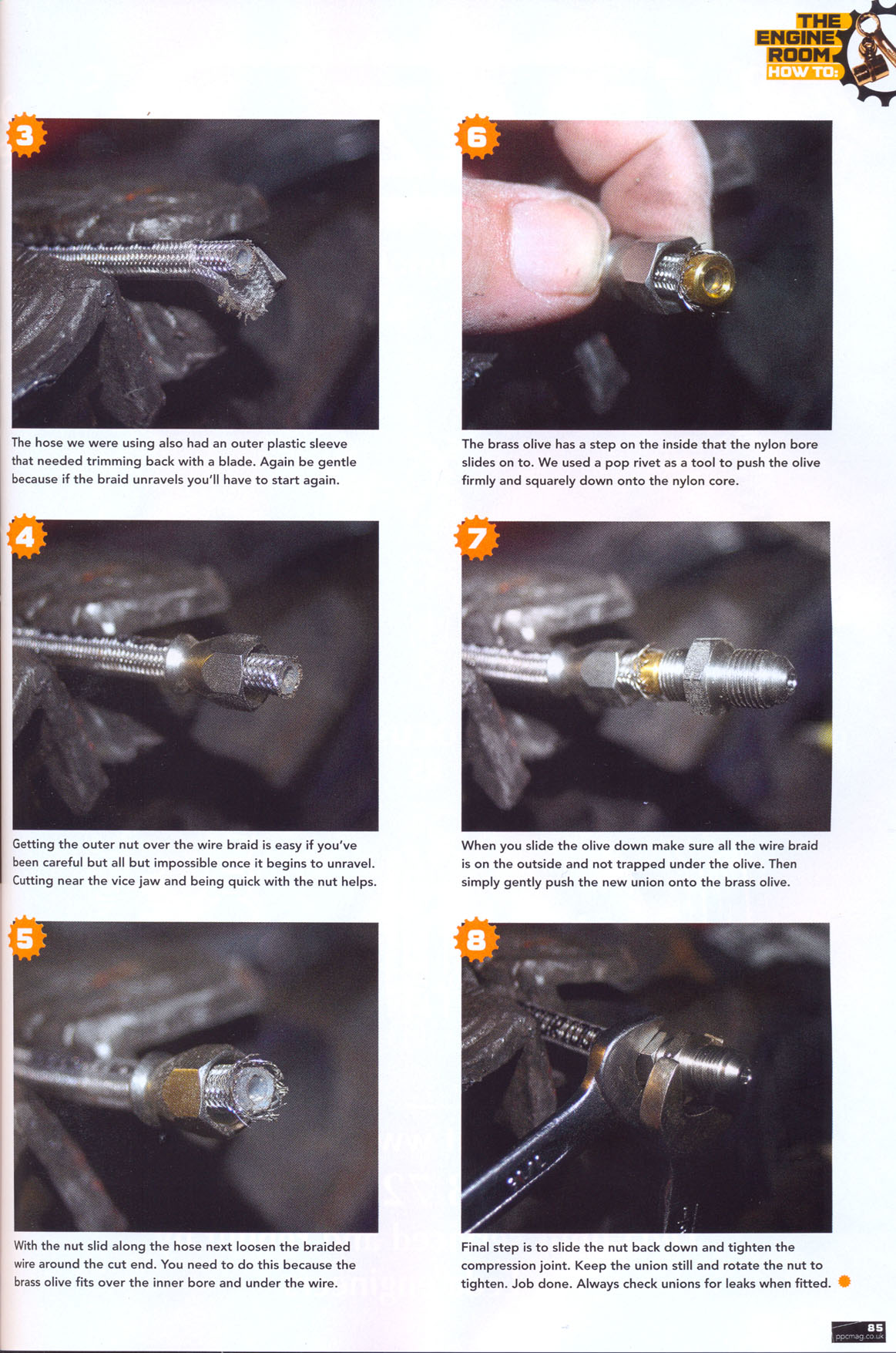

Thanks for the info, Im learning a lot as I go with this Volvo, its all new to me! There is a good arcticle in this months PPC about making custom braided brake hoses, not sure if you've seen it or if it would be any use.

OK, here's the pages, as long as you promise to buy next months issue, otherwise a guy with with a V8 Capri might get annoyed!
ppc brake lines 1 edit.jpg (326.13 KiB) Viewed 13106 times
ppc brake lines 2 edit.jpg (339.32 KiB) Viewed 13106 times

It's a bit naughty posting that up! I was going to ask for a PM with it in! Nevermind...
I'll probably try going down the 'custom hose' route.
I'm looking at the hose parts on 'Rally Design'...Can anyone suggest which parts would be needed for a 'normal' Volvo 340 hose? The Mazda calipers have a female m10x1 union, so I can use a male m10x1 on the caliper end of the hose...It's what to put at the volvo end which i'm unsure of.
