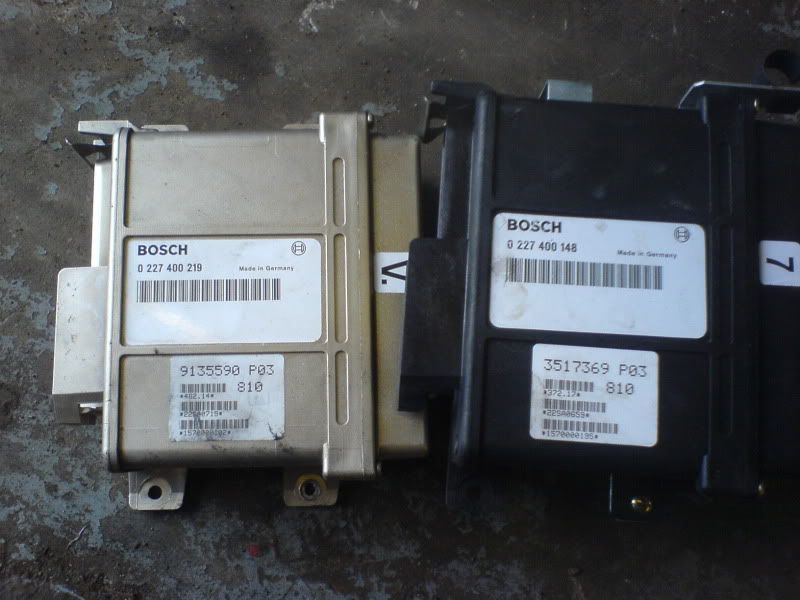

If you can, try to find an engine donor with a gold ecu, rather than a black one, as you gan get chiptuning for the gold ignition box. All fuel ecu's can be chiptuned. No matter which engine you choose, LH-2.4 from a 240 is a plug&play loom for any b23 version & ecu. It's what's normally used for conversions on 240, 740, & 940's.. As long as you know which wires to join to the car, the rest should be fairly straight forward.

PS. These are the different ecu's you'll be looking for:
Gold ign-box. remappable. 94ft Black ign-box. No remap. '93ft
My current stock. (not for sale... )
93ft ign , 94 ft fuel, 94 ft ign
91 16v ign 91 16v fuel.
