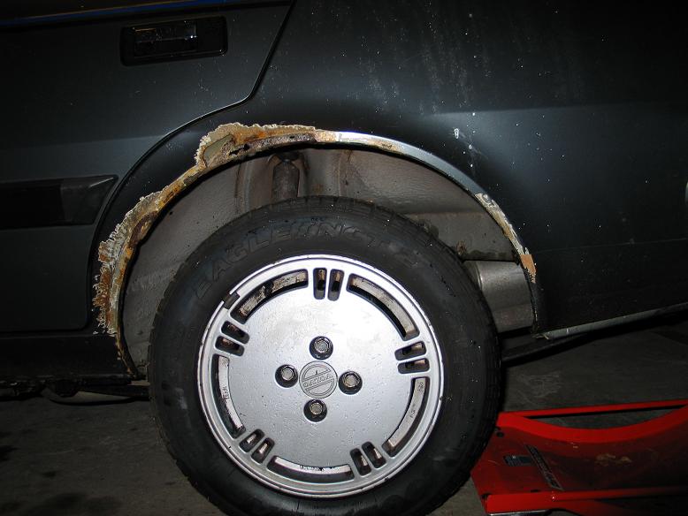

The rear of my 1987 360 GLE saloon seems rather high. It may in part be due to axle bending, and resetting the springs by loosening the bolts may alleviate it, but I intend to straighten the axle somehow.
Anyway when everything is as it left the factory I want a stock GLT look, and according to the brochure pictures, GLTs were lower in hatch at least. I like the well filled wheel arch look, but it should not over lap at the top (ie lower than the tyres), and the wheel should be in the centre of the curves radius visually.
I measured up on the level floor of the garage and got the following (floor to wheel arch)
Rear left: 63.5cm (2 deg toe in)
Rear right: 62.5cm
Front right: 61.5cm
Front Left: 61.5cm
What do others get, particularly GLTs?

Interesting that the 87 GLT came up as 37cm front (not 32-33cm or so as predicted), I also had an 87/88 GLT saloon which didn't seem lower than my GLE, although it was a bit of a bodge with 340 struts, 340 exhaust, larger tyres (but I did fix all that). My 84 GLT 3dr hatch was lower. Has something happened over the years or models?...ah see Tom posted just before me while I'm writing this..GLTs should be lower but doesn't say what year this covers to. Pity GLTs are not stiffer.
Anyway here's my measurements to wheel centre (which is harder, since you have to guess the centre), but I agree its better to remove the tyre+pressure variable.
