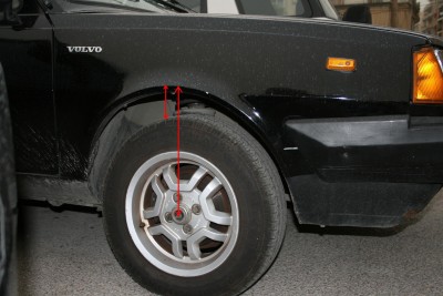

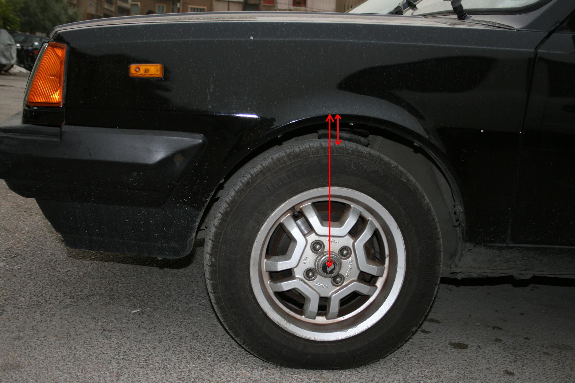

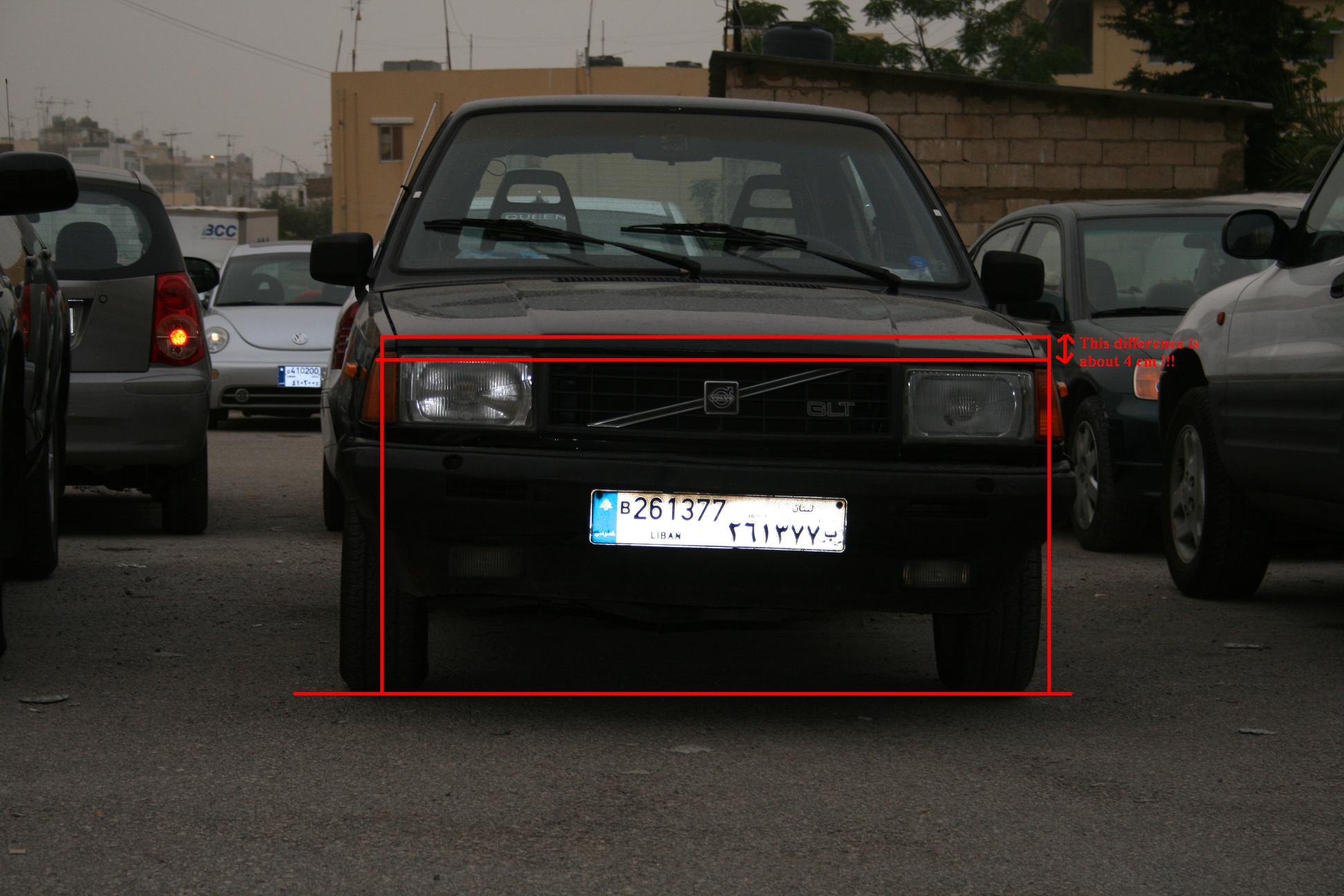

As you see on the pictures I uploaded, the car is "unbalanced"...one side is higher than the other !!!
Anw I have also changed my dampers a month ago...but this didn't solve the problem...
All the pictures I have seen on the net are lowered GLTs...here in Lebanon, people "higher" their cars :lol: because of the very bad condition of the roads (bumps,and huge irregularities...) :shock:
So when I am driving I sense all the irregularities of the road and even, sometimes, the front wheels touch the wheel arch :evil:
I hope that I made my idea clear so you will be able to help me :)
Thanks a lot :)
David.
4 cm difference !!!
4 cm difference !!!

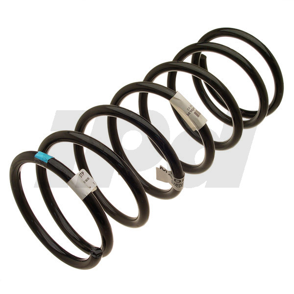

On the other side...I went to the Volvo dealer here and of course they doesn't have springs for my GLT so they showed me front springs of a 240 (I think) ... Can I replace mine by these springs ?
Thanks a lot :)
David. :360:
Front Coil Spring of the 200 series

i dont think the 240 springs will fit, however if your in a major rush i believe toyota mr2 springs do fit. but have a search on here to confirm.

If i remember right, 240s rear springs will fit. There is avaible 3 different stiffness rear springs to 240; saloon springs, estate springs and extra load estate springs. Those are longer than 300s springs.
Re: Front Coil Springs...
Post by jtbo »
240 rear springs should work, at least what I did eyeball them.
Only thing is that you might need to cut them, they are lot longer and I would think that stiffer too.
Reason why your front end is leaning to other side, maybe yoiur strut top mount has failed on other side or maybe lower spring cups are repaired and not welded to same spot other side?
You need then to lift rear end too or you will have front high and rear low, this might be a problem as front handles far rougher road than rear and you might end up broken fuel tank because of rock or something like that, but as rear has leaf springs it is not too hard to lift.
