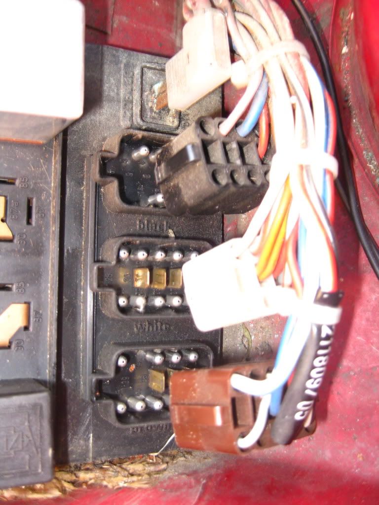

Cleaned these up with contact cleaner and no luck:

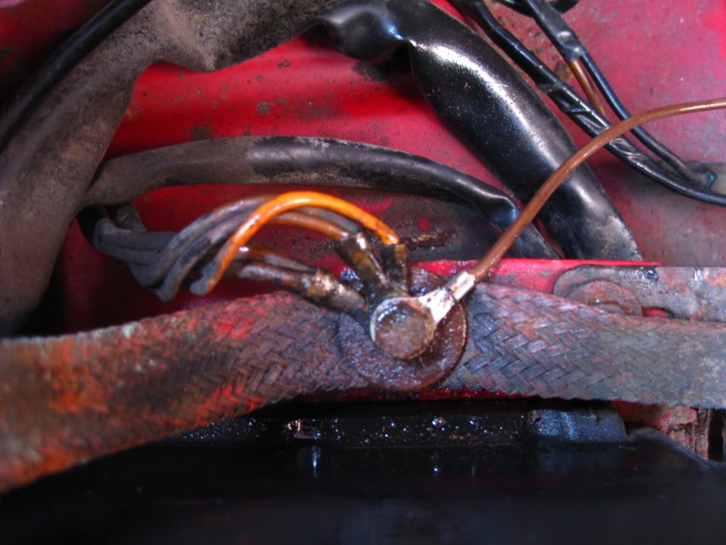

... and then had a go at this rusty battery earth cable:
... and it started! Thanks again for all your help
