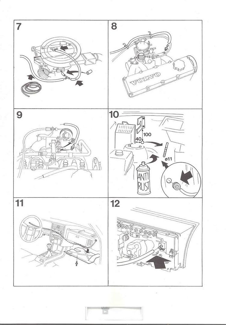

Where do i take the T-piece to the econometer on te GLE's Carb?
I can see the servo vacuum hose, two unknowns on the otherside (one on the carb one on the manifold directly underneath) and a sealed off hole (stabbing?) on the manifold, which may or may not be on the vacuum side, (the rearmost brach on the inlet)
any help (preferably with pictures) would be groovy

Post by foggyjames »
BZZZZ! For once, the blue book is found lacking. I have the same guide, and it is also missing the B200K. The B19A is featured, but not the 200K.
You need a 'large' standard Volvo tapping. I got mine from an NA 740. It fits in the 'spare' port on the inlet manifold - next to the vacuum feed for the brake servo. I probably have a picture somewhere...but you don't need that, right? ;)
