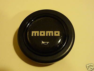

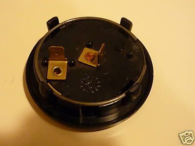

Now all you have to do is connect those 2 wires to a horn push which is usually snap fit into the wheel centre, or the boss itself. One such as this:
