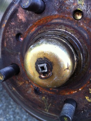

Look in the centre of the front left wheel, you should see the centre/oil cap. The clip should be around the square plastic bit on the outside:

I have just looked at it and it appears to be ok?

Benfraser wrote:I have just looked at it and it appears to be ok?
Also here is the actual cable that goes into the back of the hub..Look ok?
Thanks, any help would be appreciated :)
Ben........
Nope, grab hold of the cable, and push it into the back of the hub :)

Yup the big cable in the pic, push the throttle cable into the back of the hub. It looks like its been pulled out the back.
