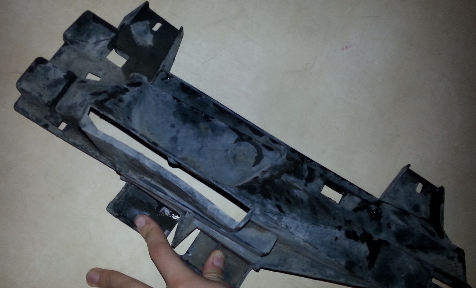

The white one is as far as I can see, there to stop the window mech hitting any door locking components. The black one almost looks like under the indicator/wiper stalks, almost.

The black one is the holder for the jack

Black part is holder for the jack (13)
V300_jack_tools by macplaxton, on Flickr
White part is (46) "protective casing" round the lock assembly inside the door. These are handed. Think it is a driver's side one.

Re: Unknown parts plz advise
"Protective casing" (white part) I'm pretty certain only came on later cars (I'm not sure which model year it was introduced) and was to make breaking in a bit harder.

Hi Chris.
My mk1 has those door lock protector thingy plastic bits lol.
The other is definatly a jack holder.

Around MY76 then Mark! Cheers mate
Think Mark's car is an '81 so you may be correct in thinking the earlier cars didn't have it, Chris!

"I think you'll find"
Jack/brace holder - pt.no.3293895 - ch.485000 (1980 yr.mod.) on
79 and earlier (different) jack carried bag in spare wheel centre.
Door handle protective guard - pt.no.3283879/880 ch.710000 (1983 yr.mod.) on
pt.no.3298302/303 ch.610000 - 709999 (1982 yr.mod.)
1981 mod. and earlier - not fitted.
