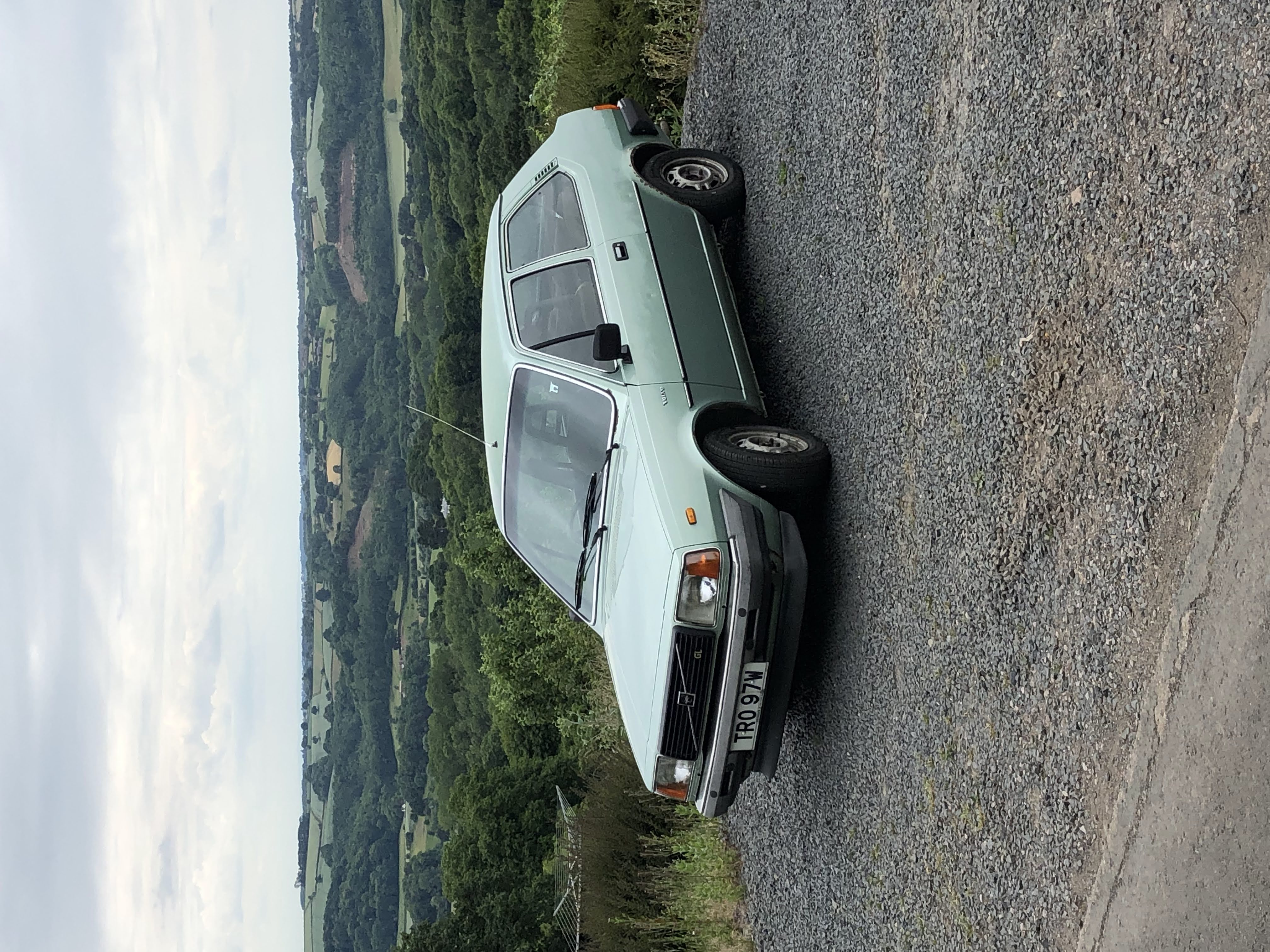

Hi,
With my son (15) I've recently purchased this 1981 343 GL 1.4 manual. He wanted something a bit different to tidy up before he is 17 and to run as a first car. It looks like it has done 38k, all the MOTs back that up. It starts and runs but is rough and lacks power. The carb is ok but needs balancing, I suspect a part of the exhaust may have collapsed too. The interior is really tidy, just missing a rear view mirror and the struts for the boot are shot. Externally there is a fair bit of surface rust, and a couple of holes in the valance. Otherwise all good. We plan to just take our time, get it running right, service it etc and then tackle the bodywork in prep for a full respray.
No idea why the image is rotated.....

Hello, great work and good luck. Hopefully rotated correctly now.
