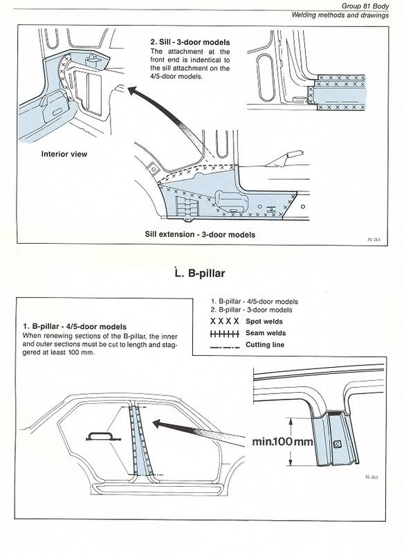

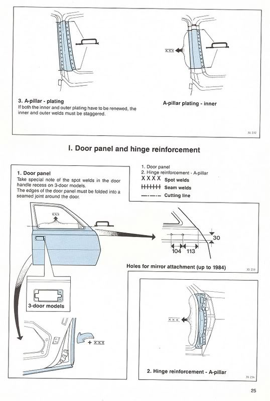

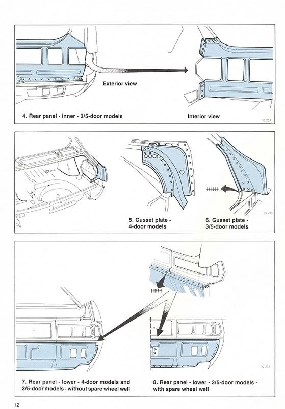

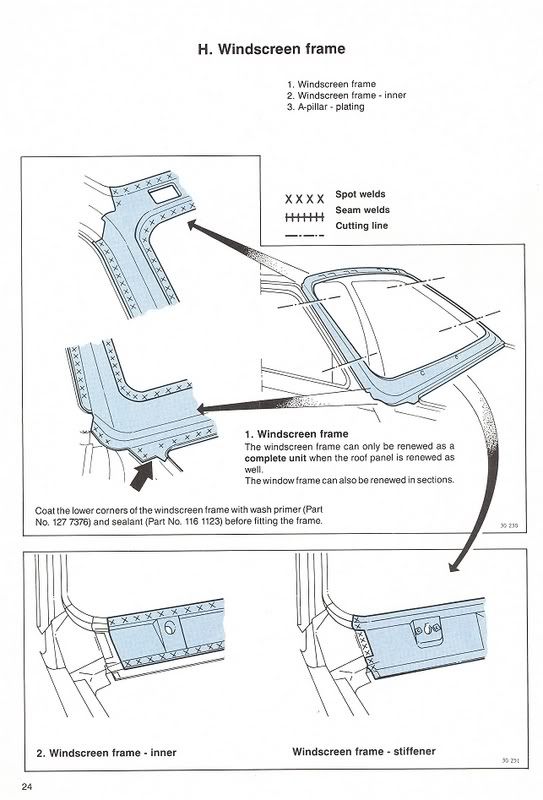

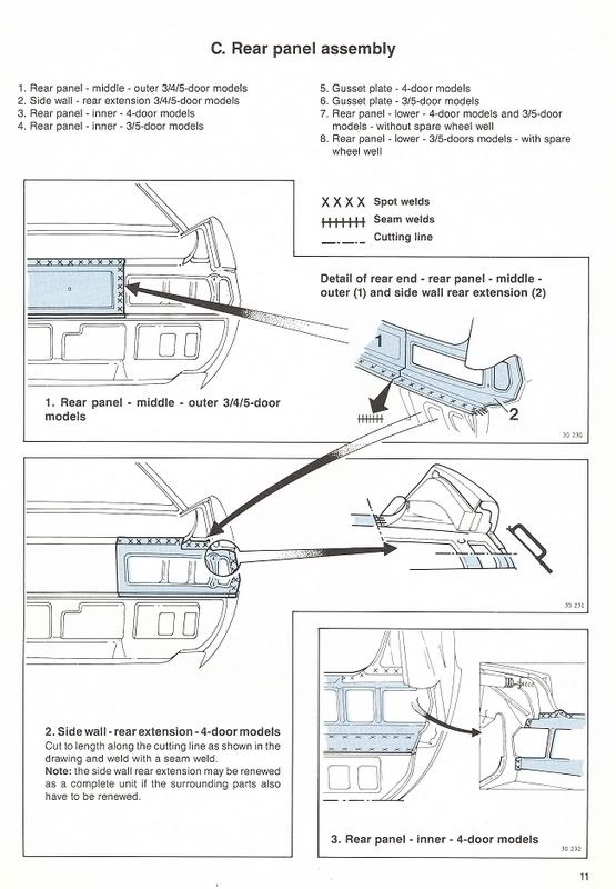

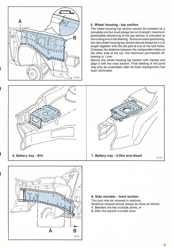

While I'm on the subject of rustproofing I thought the following might be interesting. Extracts from the factory body repair manuals.
