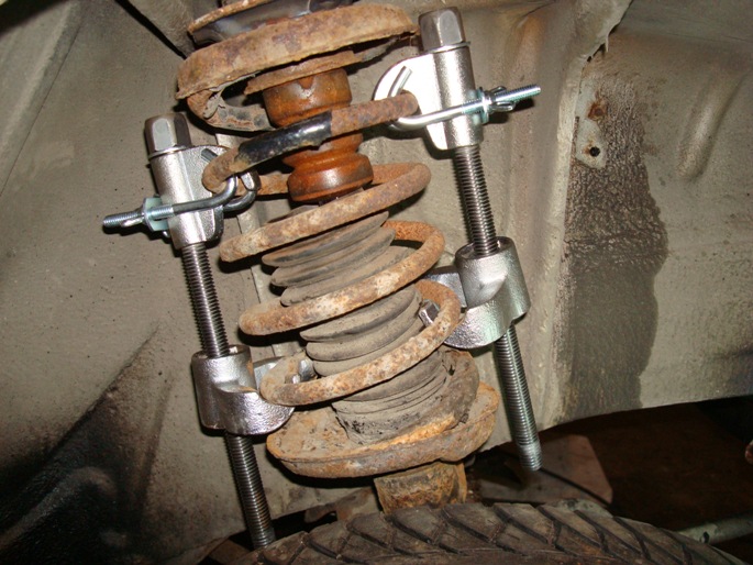

Back to the subject: the front struts of the 300! The last days I'm busy again with that model, I wish to see my red 360 back on the road for this summer. I'm breaking a GLT and I've removed the aircon and PAS, I've a little problem concerning the front strut, so there is my stupid question: how do I remove the big rubber/metal part on top of the strut? (the strut is out of the car, the spring is compressed and the big nut is removed) I there something special to do, is it necessary to use an extractor? In the Haynes they say to "remove clips", but I don't see any clips... That was maybe for older versions? I've already destroyed the bearing by playing with a big screwdriver between the big rubber and the upper spring seat... Thanks for your advice! (@ Mac: you said to be careful with spring compressors, I hope I do it right on the picture! The compressors have a little security system on the top)
How to remove this?
V3M for life!
Re: Removing/refilling front shocks?
Post by foggyjames »
I've never done it, but I assumed that once the nut is off, it's loose. Maybe it is rusted on...?

Post by Bazboy »
That nut is pesky, was a two man job when i did my springs, one to hold the flat bit and the other to unscrew the bolt, form what i can remember that should be it.

Post by Andy P »
From the sounds of it yours has seized itself in. Just give the top mount a good yank and it should come off (might be an idea to try a little releasing agent of some sort)
