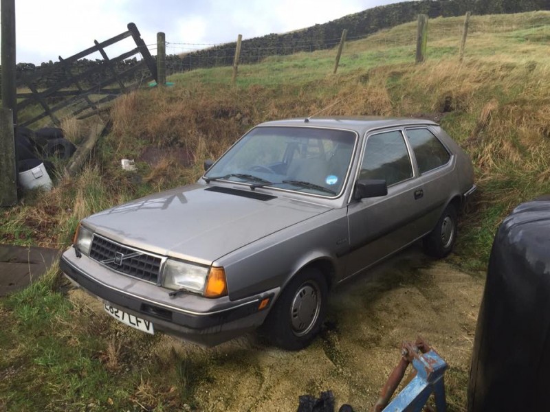

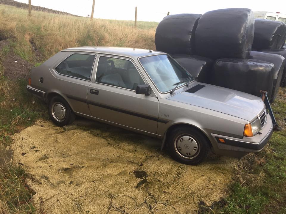

Just viewed the car today and put a deposit on it. The body work was in great condition, sill and underneath near perfect. There is a bit of rot on the front bumper where it has been knocked by the looks of it.
Only issue i was woried about is, pretty sure it seems to be leaking fuel, from near the tank. Smelt pretty strong as was signs on the floor. Also looked like gearbox/diff may have a leak. Are these common issues/something easy to fix?
Anyway, it drove sweet, started up perfect, and idle'd perfect.
Picking it up for 325, no mot, reasonable or not? These seem hard to come by. I am sold by how good condition the body work is in. Cheers guys

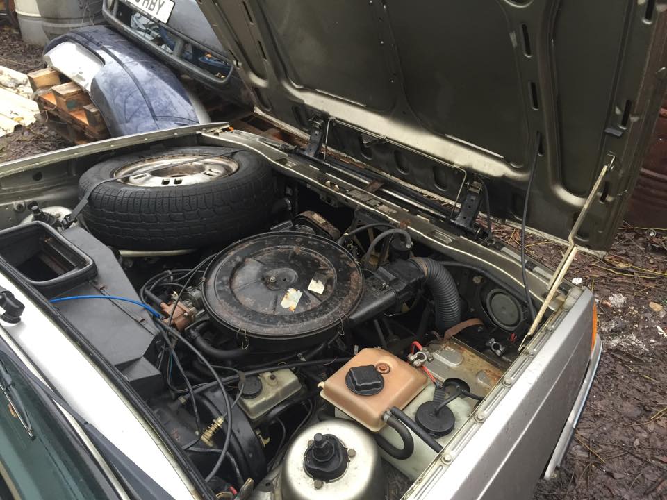

Picked her up and and was well till i took her for first long drive! Around 30 min.
Idle was too high, and the engine was dieseling, think this was due to idle too high. (pretty bad aswell, blew the brake servo vacuum hose off) So i have turned this down an no longer have that issue.
Problem now is i am having issues starting up (didnt have any issues before the long drive), its fine once started. Turning over fine just not starting. Im looking to change leads and plugs tomo, should i check inside distributor cap as ive heard there prone to issues? Just wondering if the dieseling will have caused any issues within the carb or elsewhere
Cheers!

Dieseling sounds like you may have a car that has not been converted to unleaded petrol and it will therefore benefit from super-unleaded or unleaded plus an octane-boosting additive. A bit of dieseling should not do it too much harm.
The good old idle solenoid could be dodgy and sometimes people saw the end off it to keep the car running, but it is much better to get a working one. It sounds like everything to do with the carburettor needs a very thorough oil, the accerator cable on those cars is very, very notorious for getting stuck and the engine then runs at very high revs. Cleaning inside the distributor cap is the best thing to do after that. If it still refuses to start then you need to check if there is a spark at the plugs or a lack of fuel, but you knew that anyway, if you knew how to adjust the slow-running ;-0
It is very, very likely to be something very minor, so don't jump to conclusions that its anything major just yet!! I would say that changing the plugs and leads is probably over the top until you know there is something wrong with them - better just to clean them and check the plug gaps, along with cleaning the dizzy cap.
